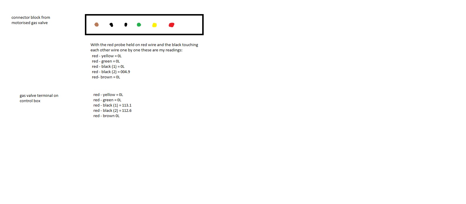

Now, at first I suspected the motorised gas valve would need replacing, but at a cost of over £300 to my customer I want to be 100% certain whether the fault is on the valve itself, or the main control box.
I did some resistance tests on both the gas valve connector block and its connection terminal on the control box...
The results can be seen clearly by right clicking the picture below and selecting open in new tab
I hope I have provided enough information to help advise me.
