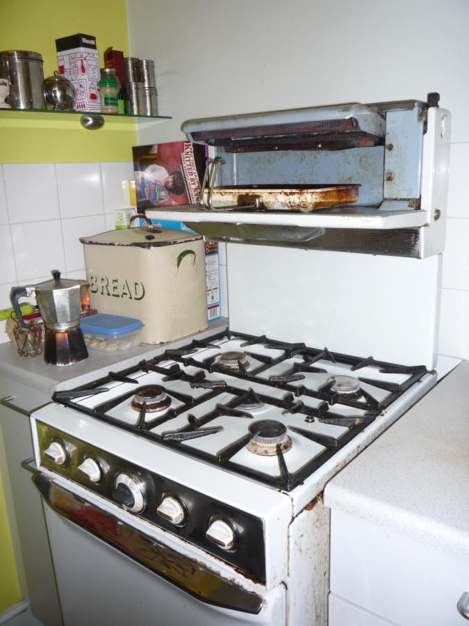

Hey! Tamz!
What are you showing them all the modern stuff for!!!
There is as you know lots of old stuff knocking about.
The thing is, I suppose like Assessor Gas seems to say, it seems gas fitters know all the rules and regulations, but perhaps little about an appliances underlying working principles.
Its a shame.
