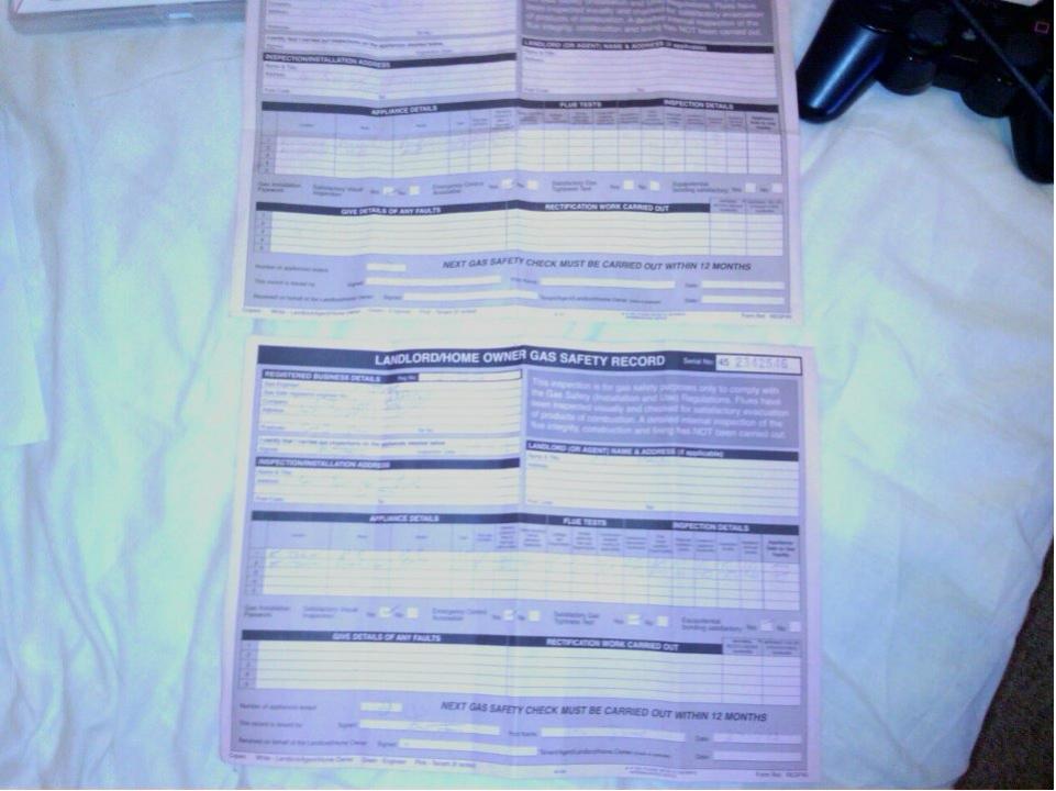

Cut a long story short i'm a student and been having difficulties with the landlord. Noticed that the Gas saftey certificate was out of date. Requested a new one and the engineers number did not show that a current engineer existed with that number. Now the thing is the certificate has only just been shown to us now not when it was originally completed. So ringing up the gas safe center we asked for a check because whilst the company name existed the engineers number didnt. I was informed that the engineer had a new number and was certified for the period the certificate was issued.
However the name on the certificate does not match with that of the name of the gas safe registered persons number that was used.
Does the certificate have to show the actual name of the engineer who carried out the work?
The name matches with a company name, won't list details but imagine it said engineer name j smith, company name j smith services, yet the registered number does not match the one written on the form.
Also the form itself has not been signed by the landlord, does this constitute a 'complete' or 'valid' certificate.
No idea if anyone will know but any help would be appreciated, i'd hate to think someone was using someone else s numbers for work especially if they weren't trained, could potential damage a reputable person and endanger life.
The company registration number remains the same but the operatives number changes every year so J Smith the company may have GS reg no 12345 and J Smith as the engineer has an ID no. like 9876543.
Ok, but what about the issue with the name not being the same on the form, we were told about the number change and given the link to the gas safe register say he was m jones, but the name on the form is j smith, which is the same as the company name, does the person carrying out the work have to fill in their correct name? What would occur if they'd signed it for someone else.

Ok so keep looking at the forms, we have been given by the landlord the up to date one. Now the first certificate is valid from 16/06/11
The second certificate is valid from 27/07/12
So the period between these two dates is over a year, of course that's fine if there was no tenants in the property during that period and as a student house it's reasonable that that was the case.
Now for a possible issue, other than the fact that the name doesn't match with the updated registered engineer on the form (which is a form REGP45) the two engineer numbers are the same, even though the inspections were supposedly done over a year apart. So if the operative number changes every year, how can they be the same?
When HSE was called they stated that the number was valid from19/02/12 to 7/11/12, is it possible that despite these taking place over a year apart that he had the same registered engineer number?
The name of the engineer should be on the cert and should match both with both the new and old numbers. If the name on the sheet does not match the name gas safe has against this number then it sounds fishy to me.
i think the number always changes every year?
are the serial numbers on the certs almost the same??
The name doesn't match the engineer number that we are told was related to the old code, we were given his new code apparently. IF the number was to change every year there would be no way he could have filled in the first form at the time of inspection as the HSE has said the number was registered from 19/02/12 and the form has the same number but was filled in ib 16/06/11.
Serial numbers for the first certificate are 45 then printed 2745260 second 45 then 2342546, i assume these can be bought buy anyone, there is also at the bottom of the page in the middl ea code, on the first that reads 451101 and the second 451009, no idea what either of these mean or are used for.
Also there are no phone numbers left on either certificate is this mandatory? Also whilst i appreciate i sound a bit paranoid here as anyone could move house, would it be normal for someone thats address is in romford to travel to chester for a gas saftey certificate roughly 3 and a half four hours, i didnt think they were that expensive.

Yes thats my worry, now to fill in some more details that i have discovered. Rang gas safe to inquire about the issues i had seen. Now apparently it is perfectly acceptable for a subcontracted engineer to use the engineer number of the person originally asked to carry out the work. So the distance issue and incorrect numbers now seem to make sense. However the number that is on both certificates which is the engineer who sub contracted the work, we were told was issued on 19/2/12, however the certificate was supposedly written on the 16/6/11. So my question after asking gas safe all this and being told it all sounds legit and i should contact the person who subcontracted if i have any worries is,
how can an engineer number that was issued on the 19/2/11 have been written on a gas safety certificate 8 months before it was issued, unless that certificate wasn't actually written when it was supposed to have been? Also if it is the case that the certificate was written 8 months after its supposed date is, is that certificate valid. Also the issue that it is the same number even though the two certificates are over 1 year 1 month apart is also apparently fine. Now the engineer who supposedly carried out the work was certified at the times both of the certificates were written but appears to either be psychic or have completed a form 8 months after doing a test.
The cert would be completed at the time of the inspection.
Obviously if the engineer has put on his operative number but didn't get that number until many months later then there is something wrong.
