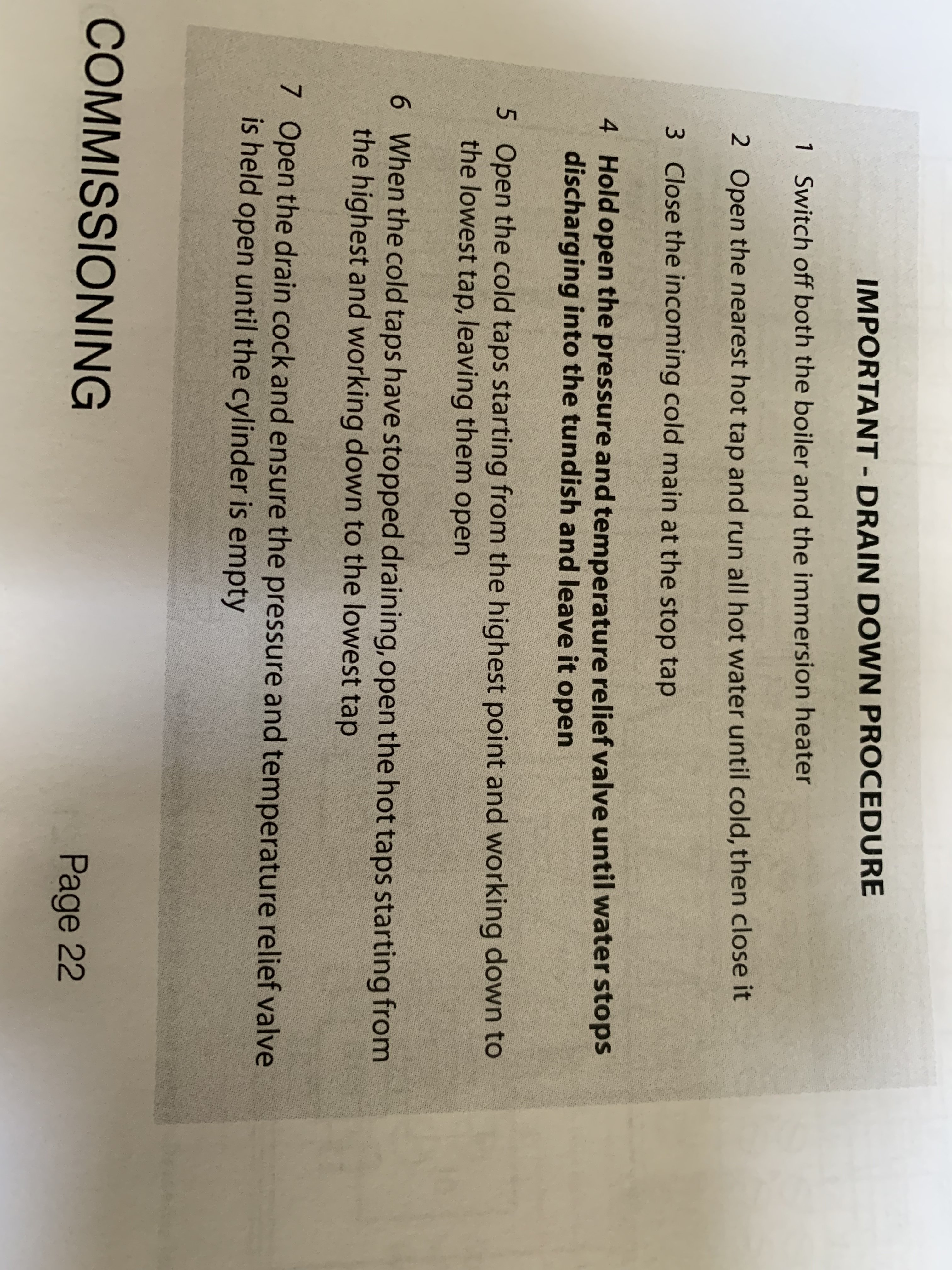

I’ve been and changed bath taps For a client by first isolating the cold mains.
I then opened the kitchen mixer tap to drain both hot and cold water and while that was draining, I went into the bathroom and opened the separate hot and cold bath taps.
The water started to slow down but the hot took a little longer to stop (no more then 1-2mins).
So I proceeded to remove the bath taps then suddenly the hot water started running from the pipe. At this stage the tap was already removed so I had to place my finger over the pipe to stop the water.
I asked the client to open the taps downstairs to which he replied “they are already open”
He then went into the loft to isolate the hot water outlet from the cylinder via a gate valve he had installed by the installer of the cylinder.

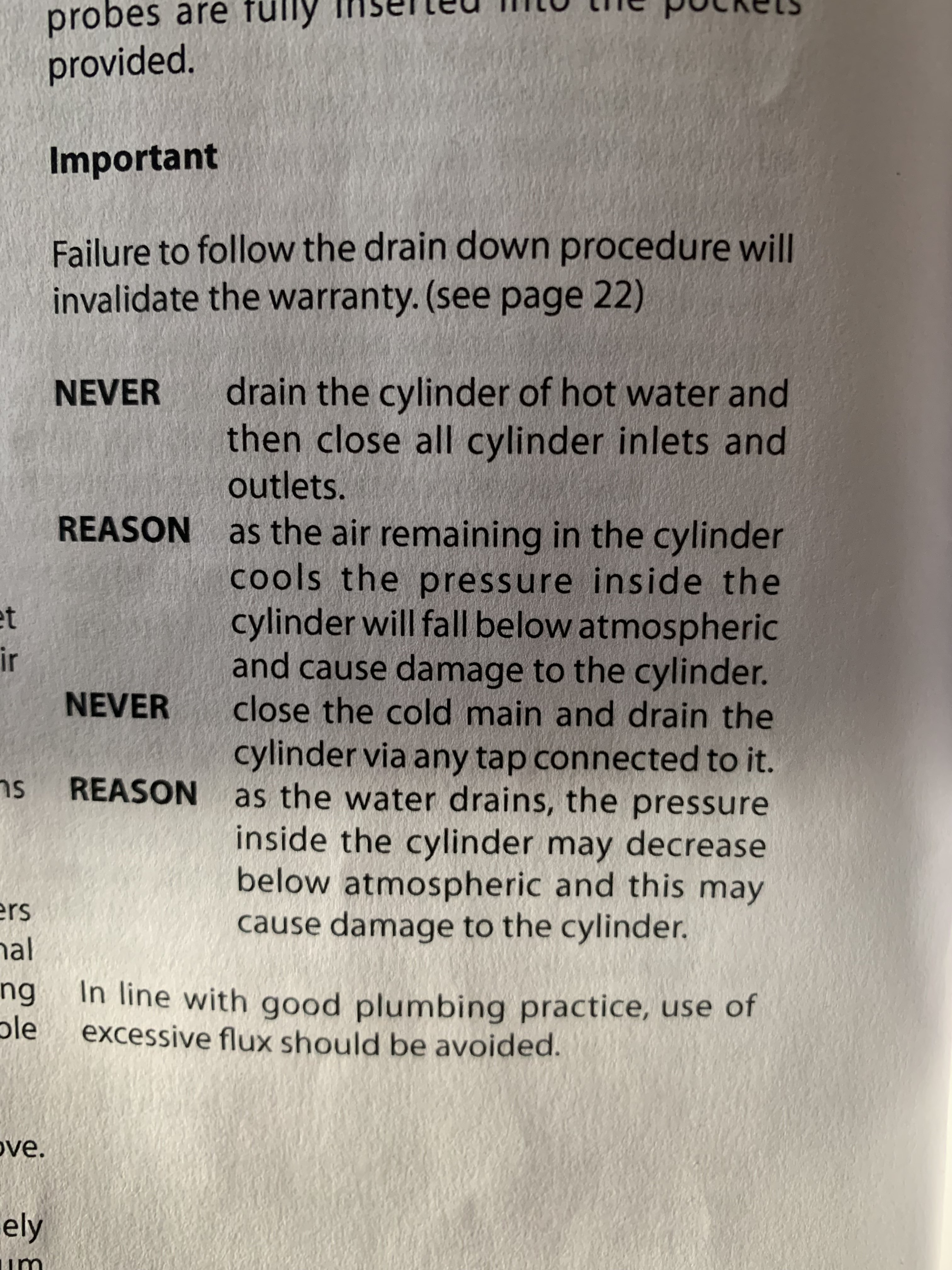

On inspection, the only thing I noticed is that the expansion vessel is installed on the hot water outlet instead of being installed after the combination valve on the cold inlet as illustrated on the manual
Would this void the warranty and cause such problem?
