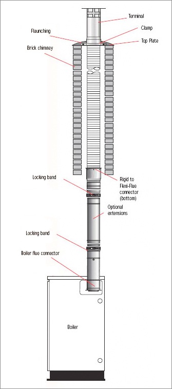

You got bad advice regarding the boiler. Grant and other manufacturers do a flue liner for condensing boilers.
