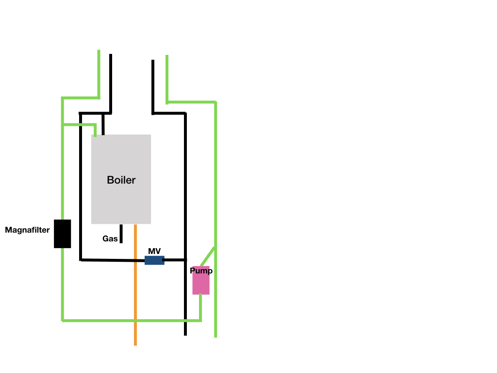

I have been told by a plumber that the piping is a little odd with the pump on the return side and that this could be the root cause of the air. However prior to this plumbing work, we had no air or noise issues at all. All rads were working very well, except the lounge which took longest to heat and cool at bottom. hence the callout of plumber to investigate this (sludge?) and installation of rad and valves.

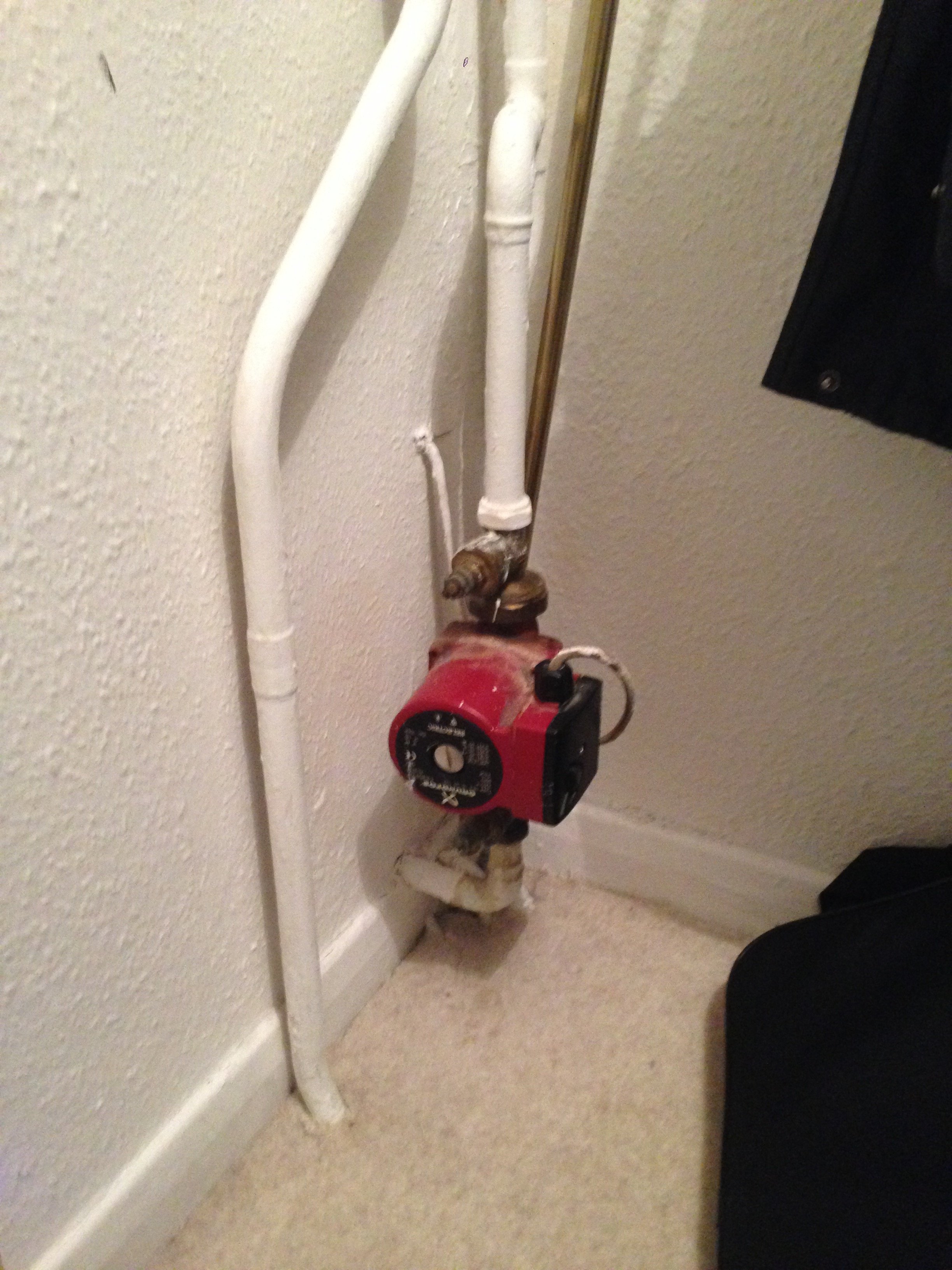

When you get home, take a snapshot of the pump label to identify which exact model you have, there are a lot of UPS pumps with various head/flow rates, depending on age, and running on speed 3 could definitely be a recipe for drawing in air.
Has the pump got a push button to change settings with indicating LED lights or is it just a simple rotary switch?.

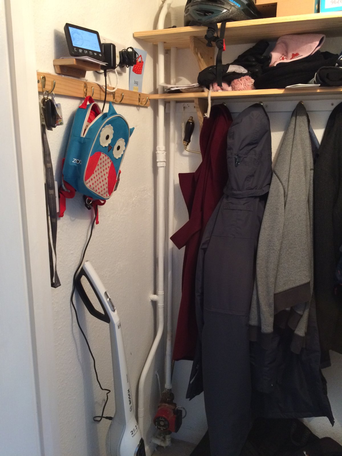

I assume also that the magnetic filter shown in photo wasn't fitted in conjunction with the above changes.

I attach a pic of the pump that is currently installed. It is a UPS 15-50 130. Currently on setting 3 with the switches on the side as seen. I will try switching to speed 2 as recommended. You might notice that the pump appears to be upside down?...

That particular pump, UPS selectric 15-50 130 isn't particularly powerful, its a 5M (4.75) pump on speed 3 and shouldn't IMO cause pump over to the F&E tank even on speed 3 but do try it on speed 2 which is very close in head to speed 3, you could then try it on speed 1 but I don't think this is the root cause of the problem.
The very hot rads IMO is caused by the now poor circulation rate, you are also getting a flow error.
If the pump is pumping downwards and to the left into the boiler return?? it just means that the pump head is "wrong" way up.
BUT just check that the pump (arrow on pump body) IS pumping in to the boiler via the return.

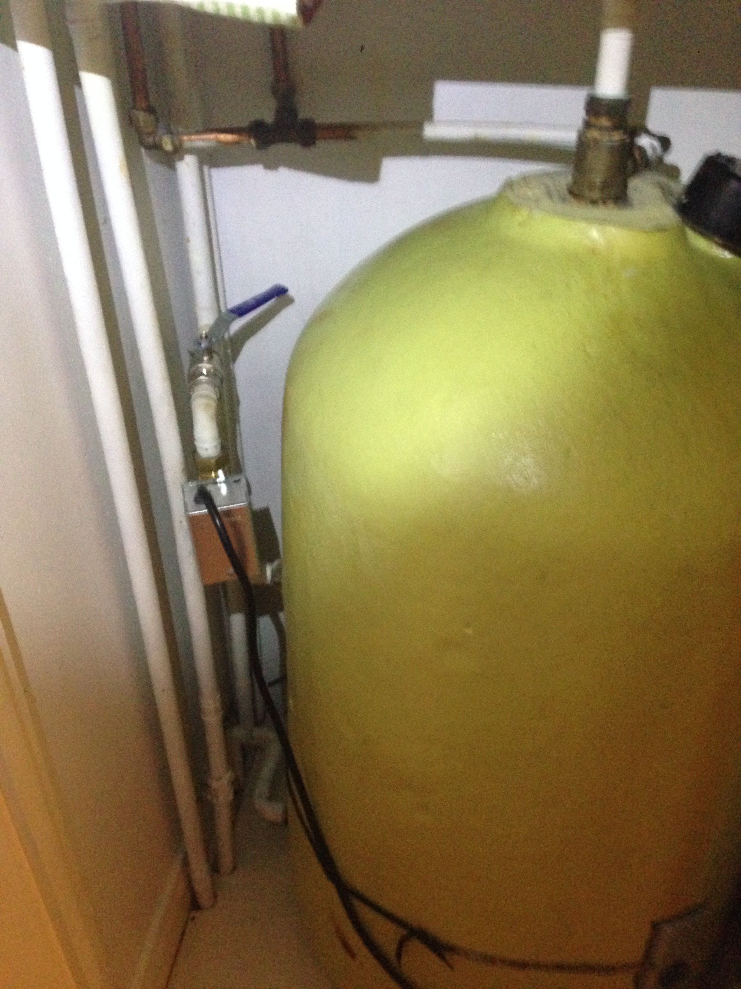

What is this "lever" that the plumber installed.?

I can see a blue ball (Lever) valve which is the one he installed for throttling the flow to the hot water cylinder?, I can't make it out clearly but the cylinder coil MV seems to be on the vertical pipe (return?) its normally installed in the horizontal section on the flow to the coil, it really does'nt matter as long as it isn't interfering in any way with the vent. The vent pipe is normally a continuation of the vertical flow to the cylinder coil and should have no restriction of any kind.
You might have a look at that set up around the cylinder and satisfy yourself that it is more or less as I described and perhaps open that lever valve fully after making a note of its approximate opening.
What I am trying to say (poorly) is that IF that vertical flow pipe up past the cylinder is continued on as the vent (which is the normal) then there must be no restrictions of any kind on it.

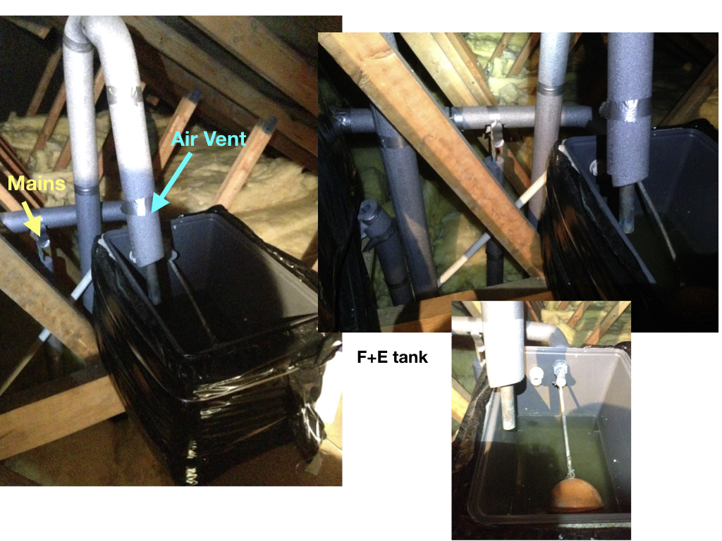

Why did he fit the lever valve?

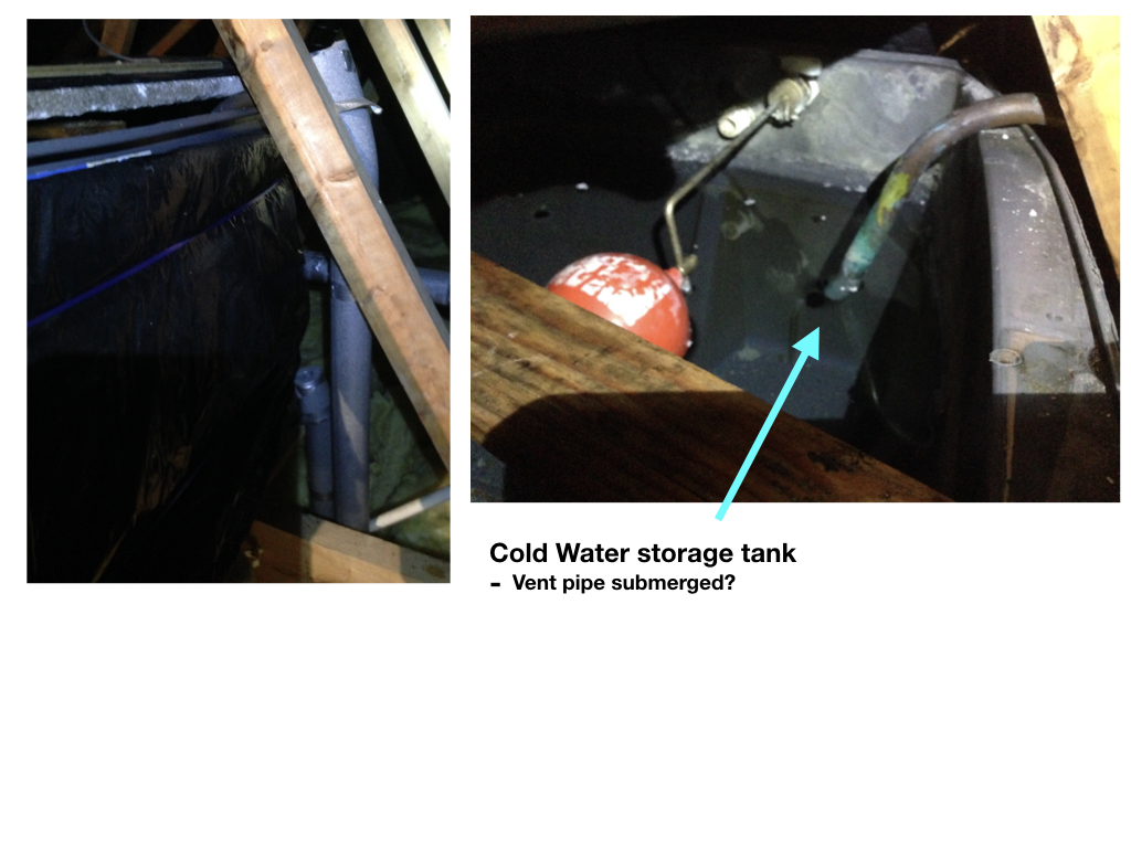

No, the vent pipe shouldn't be dipping into the water, it should be a little higher than the tank overflow level. I think that the air in your system when hot is displacing some water and pushing it back up through the cold feed pipe but then one would think that this pipe would be at least a little warm.

I think this is the submerged vent that you are referring to, it shouldnt be submerged but should be (well) above the level of the overflow from the cold water storage tank.

Your vent being below water line is not installed correctly.

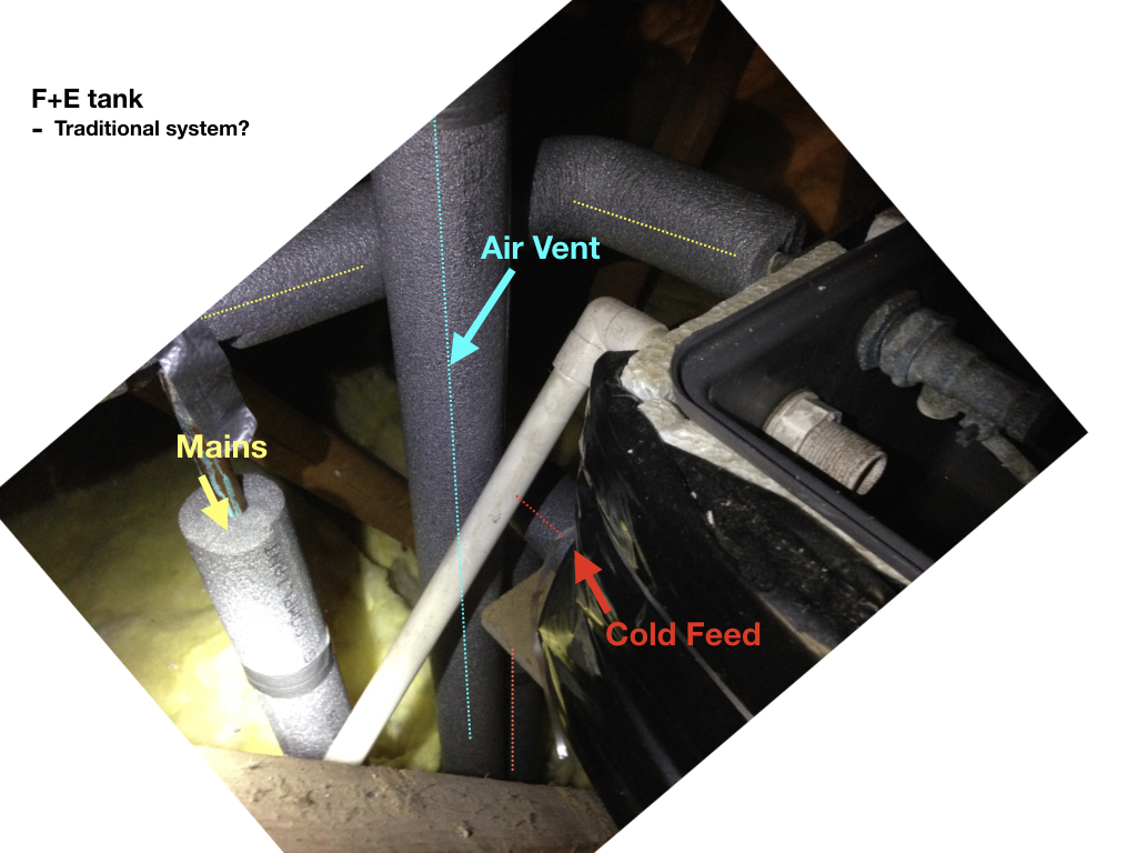

I’ve heard of combined feed and vent but never seen one. I know they’re supposed to prevent pumping over but I know they are prone for trapping air on initial filling
I have a 1/2" gate valve on the ball cock supply, I just barely crack it open when filling my system, it might take 40 minutes or so to fill the system but I have very few problems by doing this.

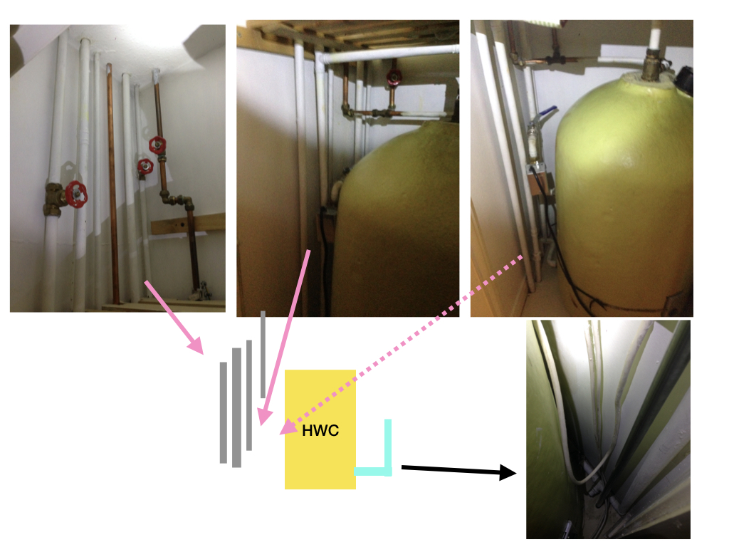

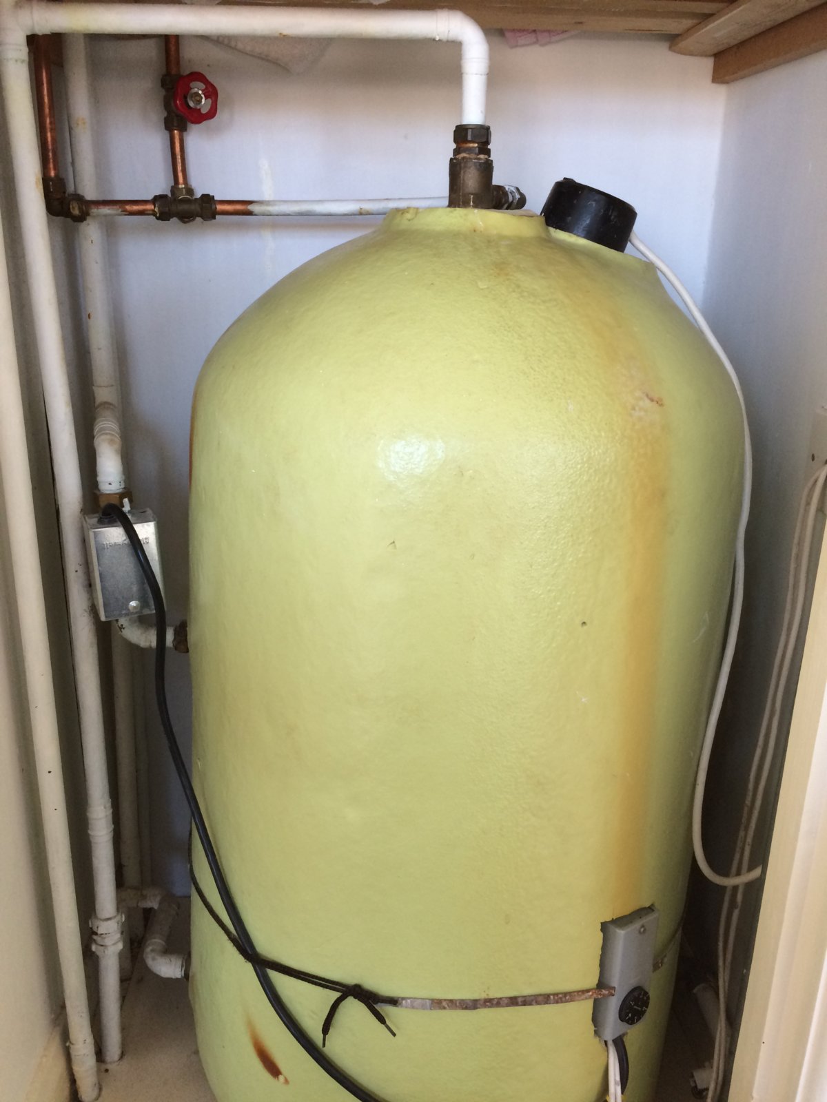

Thanks to you and John for engaging with me and for all your help. I have attached some images of my system in the loft. What I noticed when taking pics was that bubbles popped up from the F+E cold feed. Am not too sure if this should be the case or not and whether this explains why the F+E tank has got dirty again given I gave it a thorough clean 2wks ago. In any case from the pics, it looks like a traditional system though can't rule of they combine lower down. I can't make heads or tails from the piping in airing cupboard. The exposed copper pipes I think feed into the 2 showers we have upstairs. I would imagine that another 2 should be air vents for the F+E and the CWS tank.
Would be great to see what you think. Cheers.

You shouldn’t have air coming back up the feed. Also the overflow outlet in F+E tank looks too high. As for the pictures it’s hard to make out the pipework, without seeing it first hand I couldn’t be sure
Concentrating on the Boiler & F&E system, you show the pump pumping through the M.filter and then into the boiler, you are also showing another (green) pipe Teeing into that just before the boiler, is this the cold make up do you think?, it would normally (but not necessarily so) be of smaller diameter (1/2") than the pipe (3/4") its joining. Vent Pipe: It should be relatively easy to follow it from the attic down through the attic floor and see it it is in fact Teed off the hot water cylinder coil top entry.
Also can you confirm that the lever valve is on the same bit of piping as the MV and that the MV is feeding the coil top entry.
Have you opened the lever valve fully?
Is the pump now on speed 1? and if so what effect if any has it had on boiler cycling etc.
Note: IF the cold feed is Teed in at the boiler entry then its possible that the boiler H.exchanger has become partly fouled and the pump is now forcing water up through the cold feed and into the F&E tank (hence bubbles) but someone will have to ensure that it is in fact plumbed in this manner.
When/if you do run on speed 1, have a look into the F&E tank for any "movements".
Thanks for your reply,
So the green pipe which connects the pump to the M.Filter tees into the boiler and goes up somewhere. I have noticed today that after having the HW on this morning that the Green piping above the M.Filter was quite warm. Interestingly the black piping adjacent to the magna filter was cool. However, feeling the same black pipe teeing off to the boiler this is was as warm as the green pipe.
But When I put the CH on, the green pipe near the magna filter went cold and the Black pipe next to it went very hot!
When the boiler is switched off, there is a tapping noise from the M.filter (almost like when something is cooling down) and the black pipe. A few minutes later, when the pump turns off, there is water swooshing noise the from the M.filter that then goes up the black pipe. This same swooshing noise occurs when the boiler and pump are restarted.
In terms of the Vent pipe. I can't seem to follow it down (too many pipes, I get lost which it is). My feeling is that it is the same one that is connected to the M.Valve in the Airing cupboard, connected to the HWC. And yes, the lever valve is on the same bit of piping as the MV. I don't know how to tell if the MV is feeding the coil top entry??
Turning the pump to 2 has not really changed much. In fact I have noticed that the HW does not cause the boiler to fire up as frequently. so there is a period where the HW flight is lit but there is no action from the boiler. But when it does come on it short cycles like crazy. Almost every 30secs, the boiler will come off and on again and then the will be this almost cool down process from the boiler (no overheating sign ) as you can hear it making a tapping noise. I am very concerned that all of this is knackering out the boiler. Is the heat exchanger the root cause or the damage to it a consequence of whatever is happening to the CH/HW system? I had the boiler service 2 wks back and he said that it is functioning fine (with a slight kettling sound though not to worry at this stage). I will try the pump today at 1.
Thanks!
Those pipes getting hot & cold is fairly normal depending on whether HW or CH is selected, the green pipe teeing off above the boiler (cold feed) is the one to feel as high up above the boiler as you can reach, this should stay cold/cool, if its hot then it means that water is being pushed back up the cold feed which it shouldn't.
Re cylinder MV, just to the right of this you will see a very short piece of pipe going into the cylinder, this is the supply to the top of the internal coil in the cylinder, can you just follow this back a few inches and see if the MV & the lever valve are on same line?
I would suspect the boiler H.exchanger but obviously just don,t know, the pump should also be removed and checked for port blockage and the impeller might also be full of crap. If your plumber tomorrow has a similar pump with him, he might just install it even temporarily to see what effect this has. I have read that even though a pump shaft/impeller may be revolving that it may not be running at its rated speed/output hence the advice to rule out any pump problem, however improbable.
I have included a (poor) photo of my cylinder MV, if you look closely to the left of the MV you will see the vertical pipe (T piece) carrying on up, this is the vent pipe in my case.

Final say before "D" day tomorrow, IMO that lever valve is a balancing valve on the hot water coil, to give a reasonable cylinder warm up time but divert as much water as possible to the CH when both systems are calling for heat. They are often fitted in the form of a gate valve on the return of the coil and were always fitted in systems with no zoning.

Re possible blockage of cold (green) feed at boiler, if you feel this as high up as you can it may be warm as you did see bubbling in the F&E tank.
No simple answer then. Could you run the circ pump for a extended period (would need separate supply) with boiler off and see if noise persists.

Also, I have noticed that when the pump turns off whether on with CH or HW, the water levels go down quite significantly in the F+E tank. When the system is turned on again, water levels start to rise.
The wiring would have be removed in the pump terminal box and a live supply wired in there, before doing this the MVs should be manually opened with the lever(s) on the side(s).
The water level falling in the F&E tank (whatever the reason) would indicate that the cold feed isn't blocked as that is the only connection to the system apart from the vent. Can you tie up the ball cock as suggested by the plumber and see if the level changes over say 24 hrs, checked when system is cold, maybe first thing in the morning.
I think the wiring of the pump is beyond my remit.
Yes. I will try out the ball cock trick this weekend. Would the receding of water from F+E tank when the pump is off is because the water is replacing the air and then when turned on again the water rises?
The rise and fall of water in the F&E tank could be caused by either a imbalance in the cold feed line and the vent or it could be caused by the air expanding in the system when it heats up and displaces the water, it would require ~ 5 litres of entrapped air (quite alot) when heated to 70C to displace ~ 1 litre of water. If the level in the C&F tank falls almost immediately on the pump starting then IMO its the former is the cause. If you check the level on boiler start up you can verify this or checking the level from a fully hot system when the pump stops.

Thanks for the suggestion John of Teeing off the vent and cold feed. I will check this out. I did read the thread you had kindly suggested but am unsure if they ever solved their issue (which involved a much larger level of change to the system than I have). The boiler set point temperature is a gauge and not numbered. Initially it has been on quite high and I have turned it done significantly. Can't say I see any improvement to the system tbh. The short cycling still exists, air sound still trickling somewhere in the pipes and poor performance in some of the rads. I will try to set to minimum tonight. Its getting to a point where I can't see this being ever resolved but I shall persevere before considering a sealed system. I' m not inclined yet to go down this road until I am absolutely convinced that my piping will be able to withstand it. Thanks!
That thread was very interesting in that the system is fine at 65C but not at 70C, that was converted to a combined feed & expansion and it still did not solve the problem so maybe be a waste of time in your case, a leaking boiler HX was/is? the main suspect there I think.
