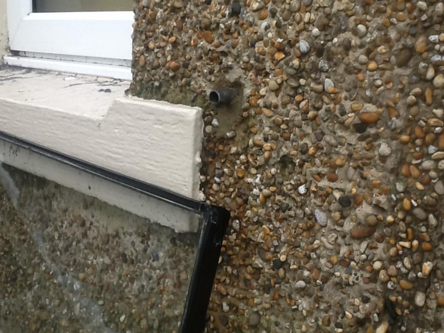

As tamz said if you look it's straightened the pulled bend in corner nice design for when drunk lol

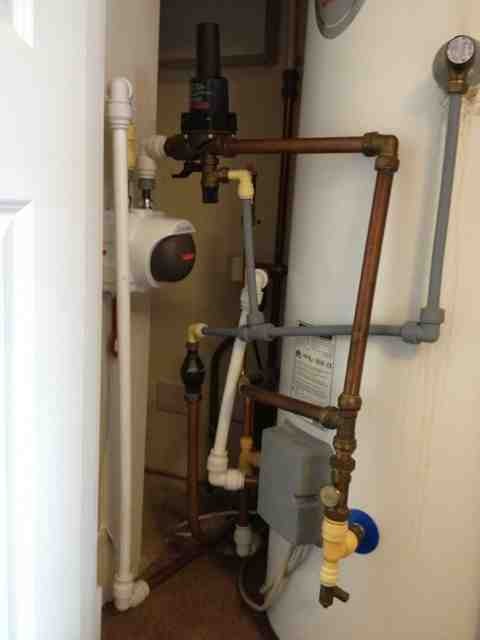

Went out to a new customer today, barn conversion all plumbed up by the previous owner, plastic pipe almost right up to boiler, plastic oil pipe run externally up the wall, plant room in the roof space, heating pump acting as a secondary circ, ufh everywhere but no timers just on danfoss room stats and the best bit the towel rails on the first floor were all piped from the roof down
