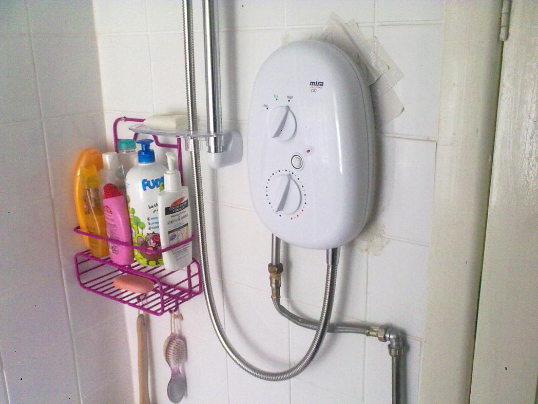

Tom that shower somehow reminds of the movie Alien!

It does look rather space-like & futuristic! Still doesn't make it right though does it! Utter poop really!

I couldn't work out what everyone was going on about at first but then I noticed how wonky the tiles were.
Reactions: 3 people
Clever spot!
So you do have your uses!
Must be your astute feminine side in you coming out again!

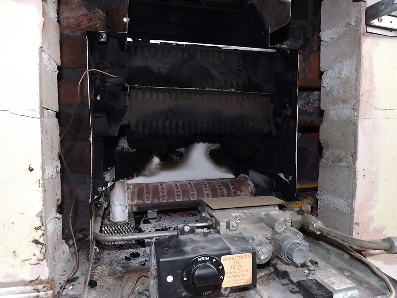

Shocking one really, I shut this boiler down a few months back as the flue had come apart due to not being clipped at all, l/lord go original installer back to repair (I'd recommended complete flue replaced as damage to inner flue duct at joints). Got a call again today from tenants as smelling this is what I found.
POC still escaping, hence the staining, also spilling into the floor void and into the bedroom above, you can see staining above the skirting! L/Lord has seen sense and whole flue is being replaced next week.
That staining and peeling paintwork is unlikely to be from leaking poc's Roger unless they are burning coal. Did you fga the inlet?
needs supporting for sure, rest is a building in need of repair. agree with tamz and check for co on inlet air intake to prove seal in flues
Agreed building is in poor state throughout, but Definatly spilling poc, didn't need Fga to check for the smell of fumes in there it absolutely stank.

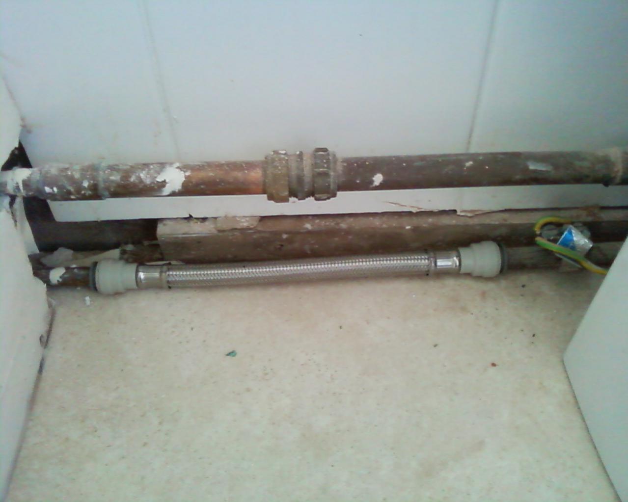

That's the main earth bond so it means the rest of the system is not bonded. All that does is earth just the stop tap and is actually more dangerous than not bonding at all. They have turned an isolated metal fitting into a route to earth. The rest of the plumbing in the property is copper or galvanised iron. Should there be a short to the pipework and someone touched the sink and that tap they would have completed the path to earth.
Should have said that,despite a lot of people thinking otherwise, water is not actually a very good conductor.
Gotcha, bondings a bit of a mine field. seems every spark has a different opinion. the fact all new sevices are plastic doesnt help though because the earth leakage has to go to ground which is like you say through a poor water conducter and in the case of gas meter bonding to nowhere exept back up to a hopefully bonded pipe.. unless pme is involved of coarse.

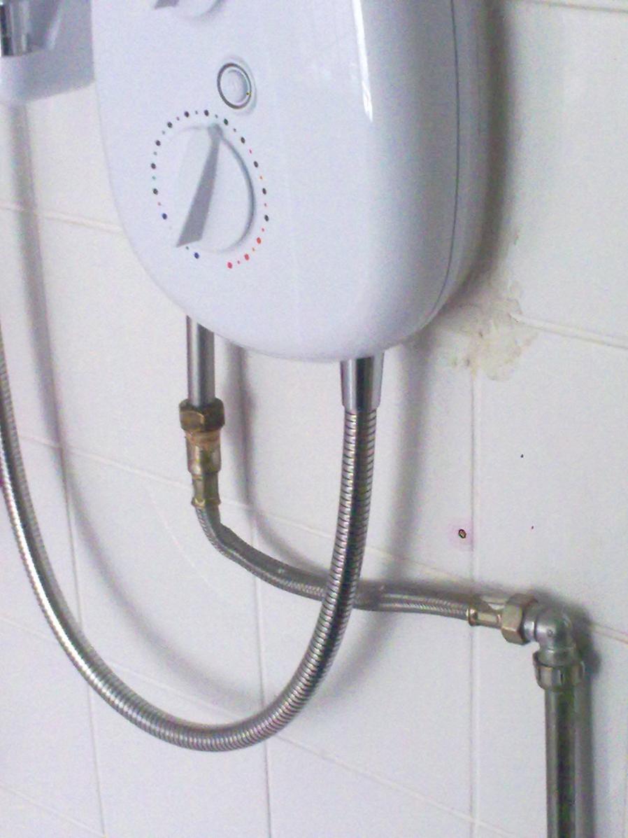

I dont know whos to blane though ! The cutomer or the cowboy ! Ok the customer might not understand electrics but from what the shower looks like with flexi etc id say its wrong !

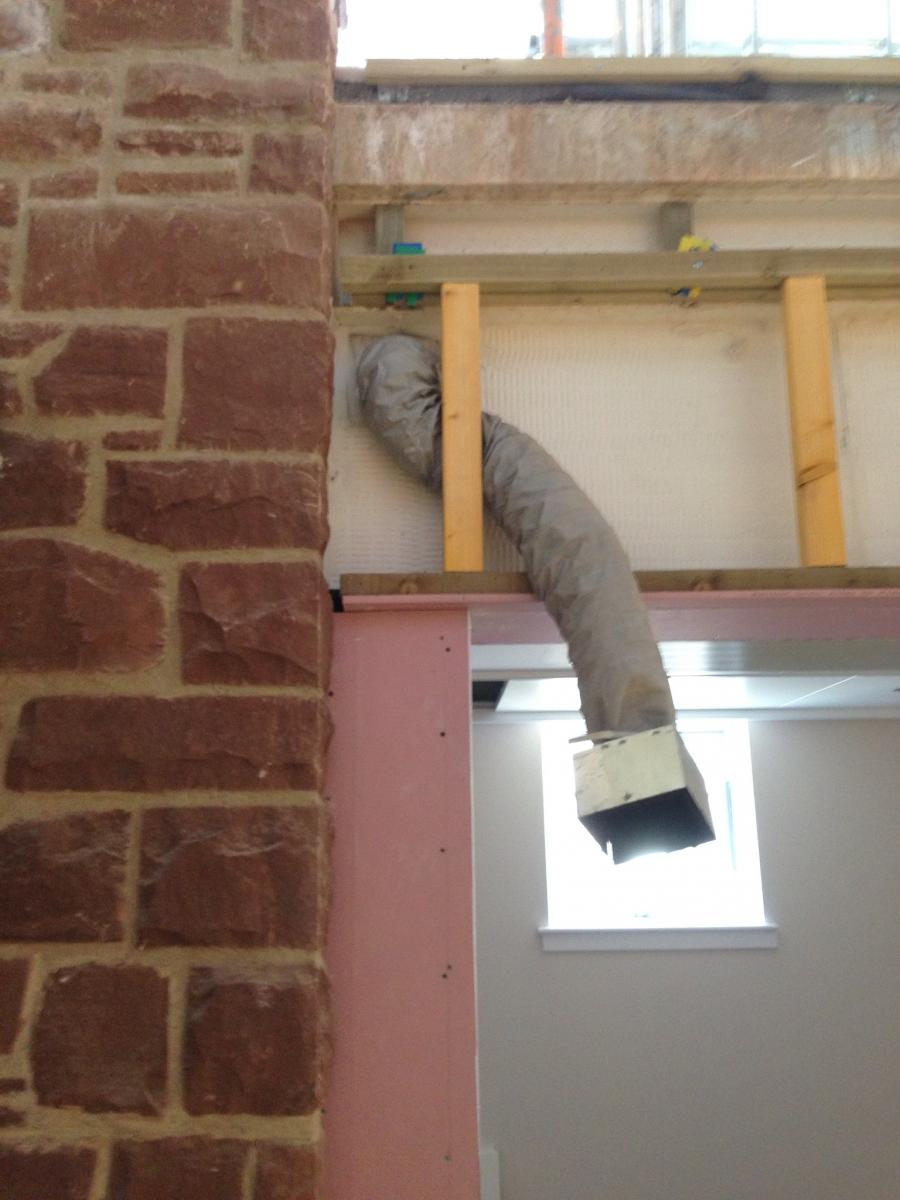

Ventilation for a 15kw fire on a new build. Think it's just passable!

15kw fire.!!!are they mad..would be cheaper to sit in the car with the heaters on..yeah pass it, nutters.
It's a golf club, that we are working on and that's fire one of seven!
