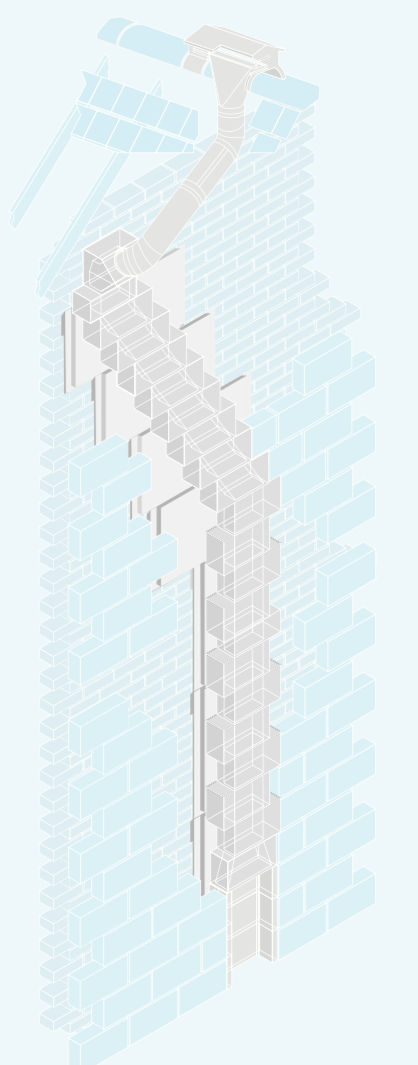

Just been researching this a bit an this is the type of flue that's installed so the image of the underneath of the flue block is most likely what these lot refer to as a 'Cover Block'.
