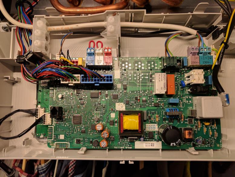

I have a vaillant ecoTect 832 (combi boiler) with a vaillant RF 350 thermostat and I am looking into replacing it with a smart thermostat either the nest or the hive.
I am guessing I will have to remove the RF 350 panel from the boiler for this to work, right? I did not keep the original panel. Hopefully this won't be a problem.

For the nest I need to identify what sort of system I have. Switched live or low voltage. Can anyone help with this?

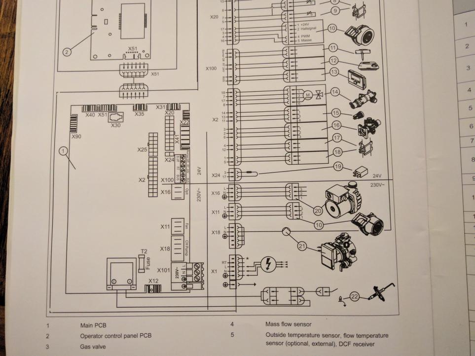

Also the boiler's manual and the boiler's board don't have any reference about the pins 1, 2 or 3 which are mentioned in both manuals.
I have a slight idea that one of the loops either'burner off' or '24v= RT' will need to be removed and connected to the heat link.
Can anyone help me identify where the wires for the pins 1, 2 and 3 should be connected in the boiler for the nest and the hive. It would be help full if someone could annotate on the picture where the nest and the vive connection should go.
Here is a picture of the board:
Here is the schematic from the user's manual:
the full manual can be found here:
https://www.vaillant.co.uk/downloads/training-centre-maps/new-erp-manuals/0020209591-00-new-ecotec-plus-user-manual-491470.pdf
11 is 'contact thermostat/burner off'
12 is 24v dc room thermostat
13 is bus connection
