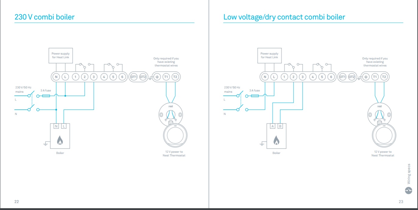

[FONT=&]I know there are a lot of threads on this forum, on a number of other forums and also videos on YouTube but I have found little information on this specific install and the information I have found has been confusing and sometimes contradictory.[/FONT]
[FONT=&]I have just had a Vaillant Ecotec Pro 30 installed a couple of days ago and have only now just received our third generation NEST.[/FONT]
[FONT=&]I have read the instruction manual and researched for a good few hours now on the net to find out how to connect the HeatLink to the boiler.[/FONT][FONT=&]
[/FONT]
[FONT=&]
[/FONT][FONT=&]I have read Vaillant and NEST threads that say follow the 230V Combi boiler page above and also read threads that say follow the Dry Contact page (otherwise you'll fry your boiler PCB).[/FONT]
[FONT=&]Hence I am confused![/FONT]
[FONT=&]There seems to be more posts suggesting the following connections (230V Combi page):[/FONT]
[FONT=&]Boiler 3 (Live) to Heatlink L and 2 (Loop wire from L to 2)[/FONT]
[FONT=&]Boiler 4 to Heatlink 3[/FONT]
[FONT=&]Boiler 5 (Neutral) to Heatlink N[/FONT]
[FONT=&]Could someone who has fitted a HeatLink to this boiler or an equivalent Vaillant offer up some further guidance? [/FONT]
[FONT=&]Many thanks in advance![/FONT]
