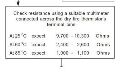

Check the dry fire thermistor value. Apart from that it's as you suspect, a blocked something. I would still take the sump cover off and check for blockages in there. It's dead easy to remove and goes back ok too. There's a hole centre/left that goes straight down to the condensate sump.
Any idea on what the resistance should be....i dont have a manual. will do as you say and report back tomorrow. gonna phone ideal tec when i'm there too.
Yep
