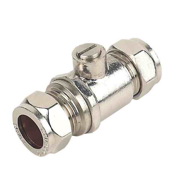

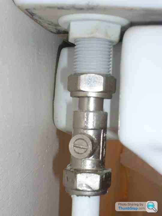

To what your describing it sounds like a 'toilet iso valve' normally chrome, top end is like the tap connector with a fibre washer, other end is a nut and ring to compress on pipe.

Bang on, that looks like the fella. Could i / Should i use it for a shower, it must be reliable i guess? although will be concealed in the stud wall
