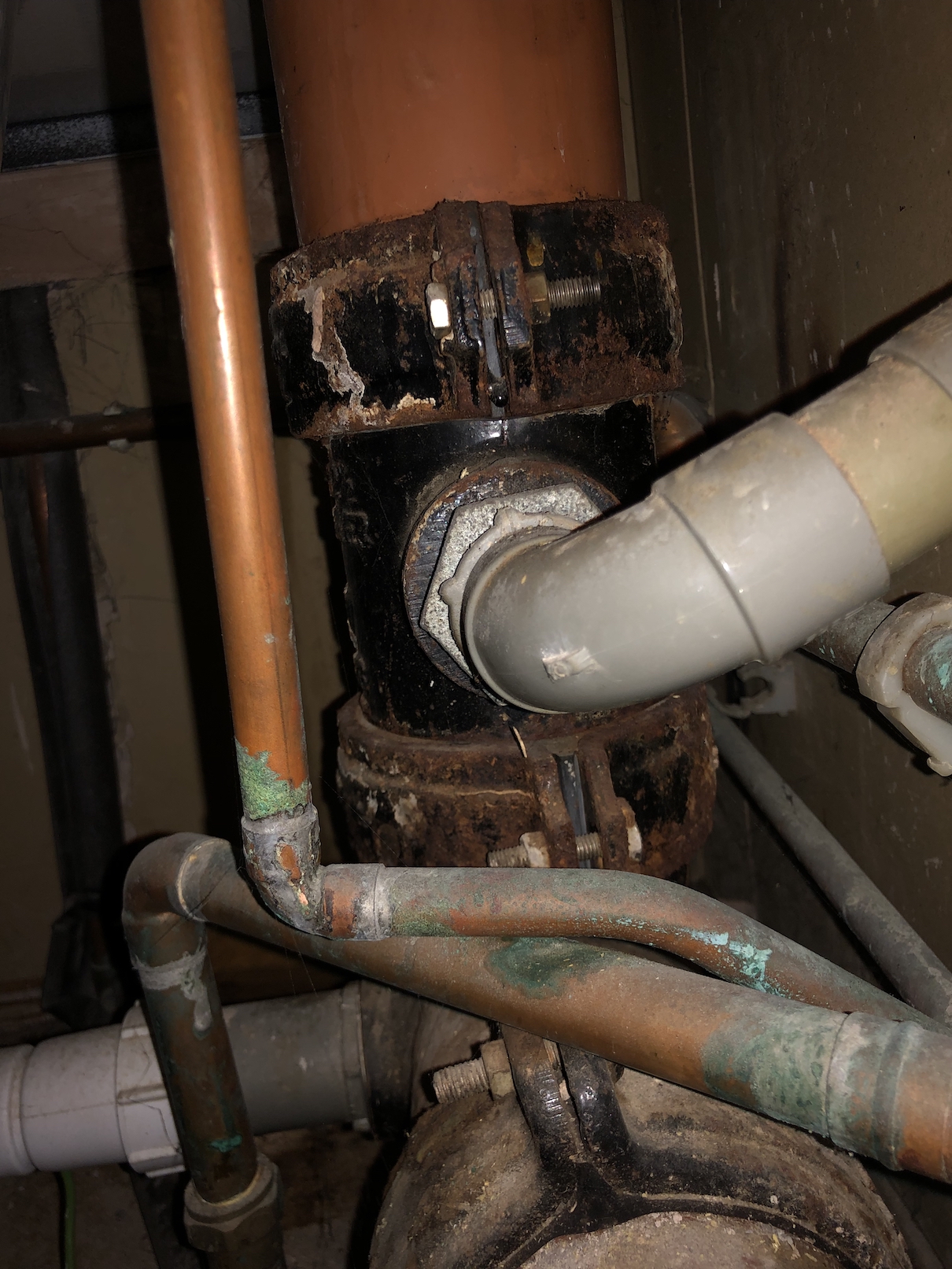

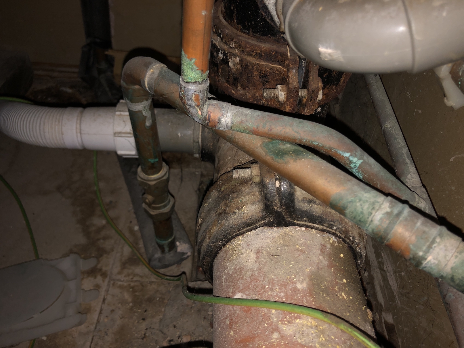

I'm about to embark on a bathroom refurb (mostly DIY). All the existing pipework is behind fitted furniture and this afternoon I took some photos from the cistern access panel to get an of what lurks behind. Ignoring the pipework which will all be removed and refreshed, the existing soil pipe connections caught my eye.
I'm the top flat of a two story building, and this soil pipe has connections for the kitchen waste, bath, toilet and toilet basin. I can't get a closer look without taking more of the bathroom apart but it looks like the branch section is cast iron, connecting to an upper vent pipe in plastic. I've no idea if it continues in plastic or iron below. The flat was built in the early 1990s if that helps.
Would it be a good idea to replace this aged looking setup or is it better to leave as is?
Many thanks

No it's not acient its cast iron time saver and is used quite alot commercially as yours is a flat it's not unusual to find it being used I would leave it alone and adapt it to suit you new layout no offence but it's not a job for a DIYer really but saying that you should be able to use what's there . Kop
Reactions: Lou
Local council estate near me built in '62 and probably 90% of the original cast-iron stacks are still in use today. Pipe walls were 1/2" thick and when I checked under an access cover in around 2005, they still seemed to be in a very good state internally. Much quieter than plastic too. Money no object and if there were no environmental impact in disposing of the existing, working, PVC pipe and the manufacture of new cast iron, I'd fit cast iron in my own house.
My own house has some cast iron rainwater goods on it that I reclaimed from a house built in the 1930s. These were never as thick as soil pipes, but will probably still see me out.
I expect that even if the joints fail one day, they can probably be replaced without taking the whole pipe out (unlike traditional cast iron, which can be a bit of a bugger). Only thing I would say is that you might find the existing branch connexions are not exactly where you need them and it may be worth having the the top few inches of the cast replaced with plastic to make your DIY work easier. Of course, if you can connect to the existing branches, all the better.
Consider yourself lucky.
Reactions: Lou

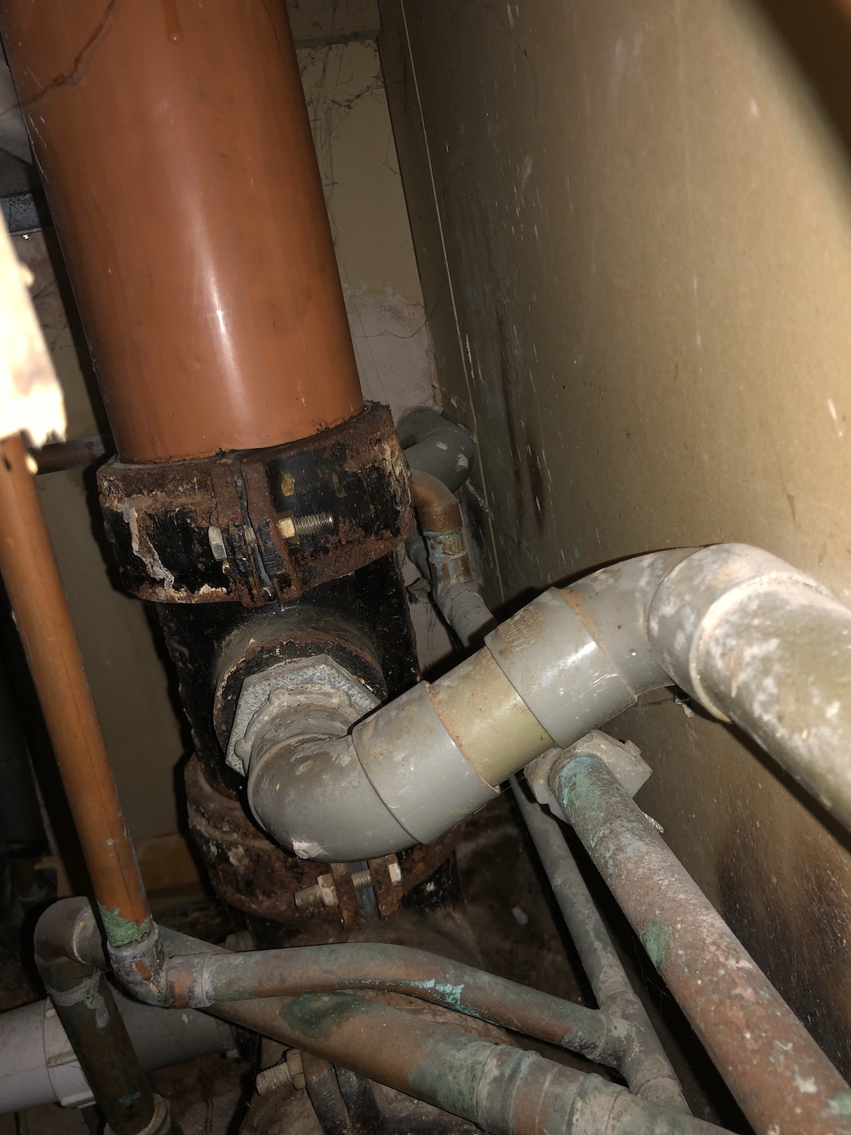

Thanks again KOP. I assume I can remove everything back to but not including the metal hexagonal fitting (yellow outline)? It looks like there's a thread there that the 32mm plastic connects up to? Thanks again

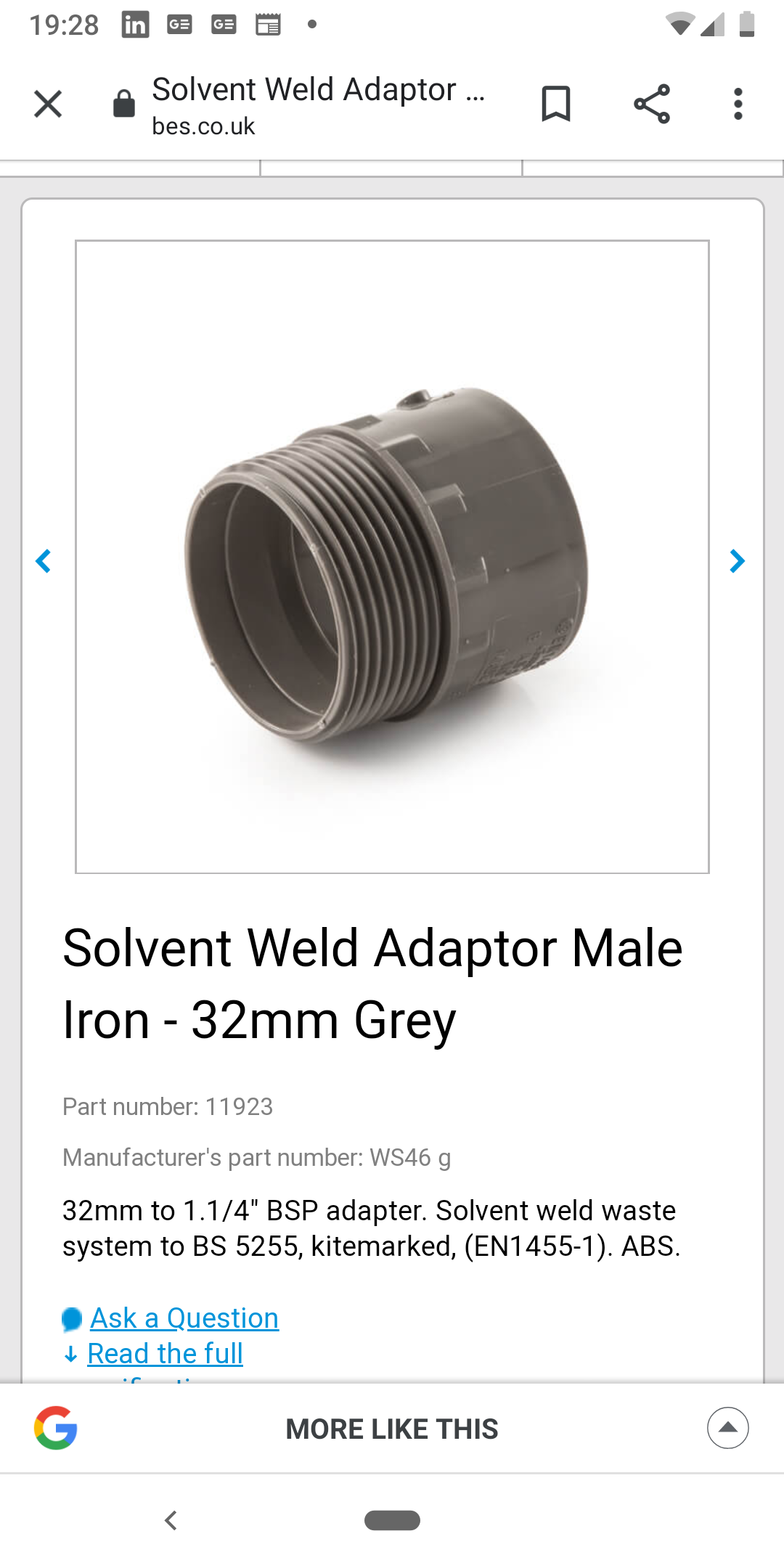

Yes mate you will need a adaptor like this 32mm to 11/4" bsp if it's a basin 40mm to 11/2" if it's a bath or shower Cheers Kop

Usually find that tapping on the side 50mm , what i would say 2inch,
Looks like someones put a galvenised 2" reducer in to either inch and half or inch and quater. Depending on what your running into it.
