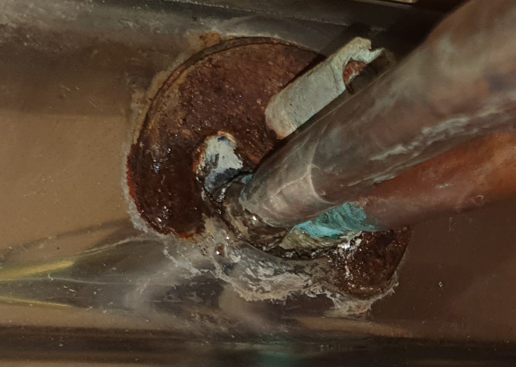

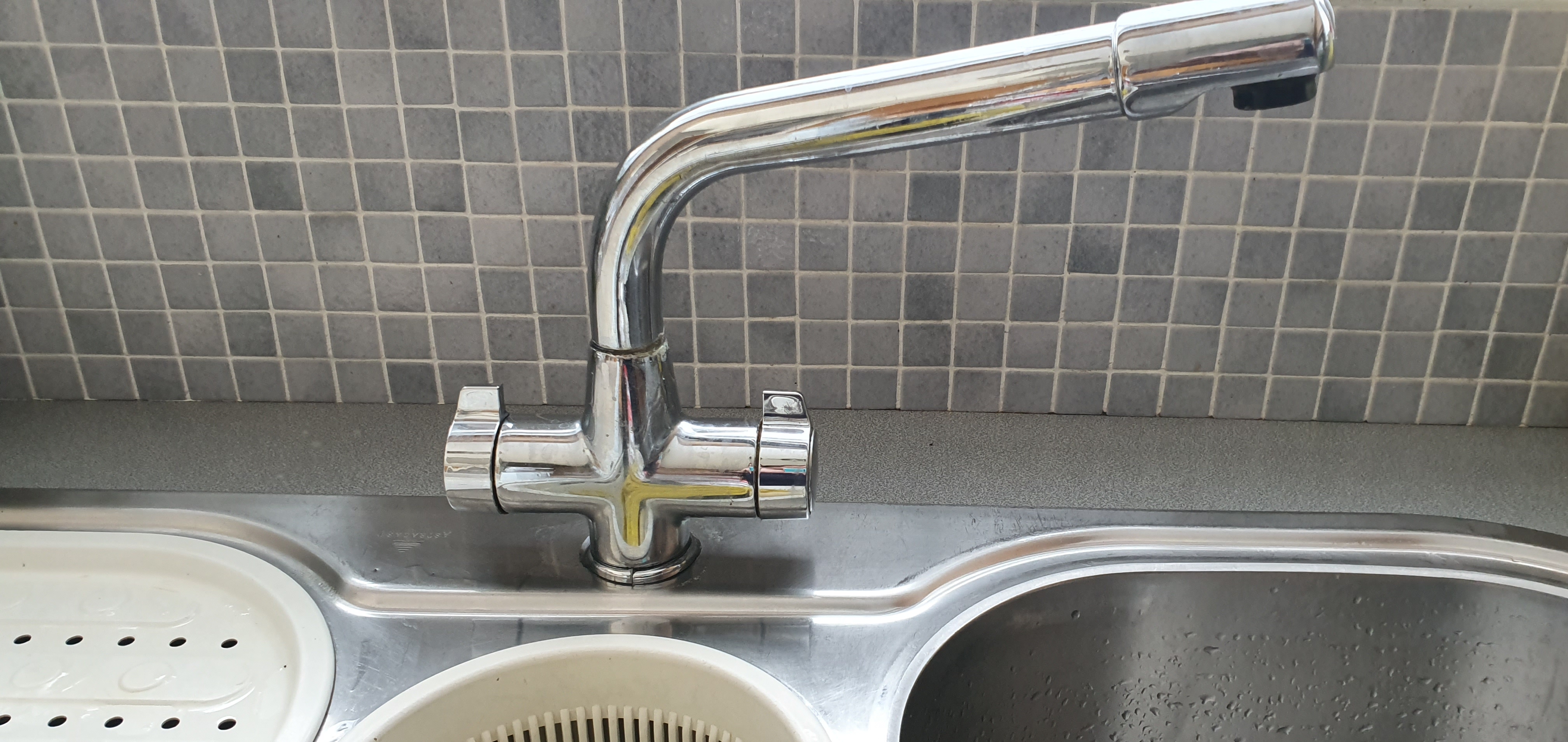

I have a kitchen mixer tap which has developed a leak. It has been installed and without leaks for 18 years so I suspect a perished seal?
I attach photos of the mixer tap and the underside where it is weaping.
I would appreciate some advice on how to fix this.

The seal between mixer and sink might have been not sealing the joint, or mixer not centred on hole properly.
(Edit, - just had second look at photo and looks like the base is cracked, so that could explain the leak).
Or the pipe tails have been leaking.
But it is rotted now and risky.
18 years is a very long life for modern taps.
I can't see a crack in the base. Do you mean the rusted base part?

The mixer above sink - chrome base seems to be split dead centre front if my eyes see right.
Some of those bases were stupidly made of chromed plastic, so very weak.
To remove that old mixer will depend on if that nut on the bolt underneath will slacken. Or hopefully the entire bolt will screw out. The leak has unfortunately corroded and no doubt seized it all.

Ah yes I can see what you are referring to. The base appears to be in two semi-circular sections. There is another divide line 180° at the rear of the mixer. The base surround does appear to be chromed plastic. Is it purely decorative or does it also provide a seal?
I have looked at some new taps of a similar design and they do indeed seem to have integral flexi hoses. That seems like a more sensible plumbing solution. It would also allow service valves to be fitted at the same time as fitting the new mixer.

When you buy one, feel its weight. Light weight = poor quality (no matter what the price). See if the part that has split on yours is brass or stainless steel. Plastic will crack eventually split if tightened up hard. Make sure the stud supplied is either stainless or brass too. They will not rot as the cheap steel one you have has.
If you wish for reliability, throw the flexis away and fit copper tails.
Take your time when centering the tap & all will be good.
