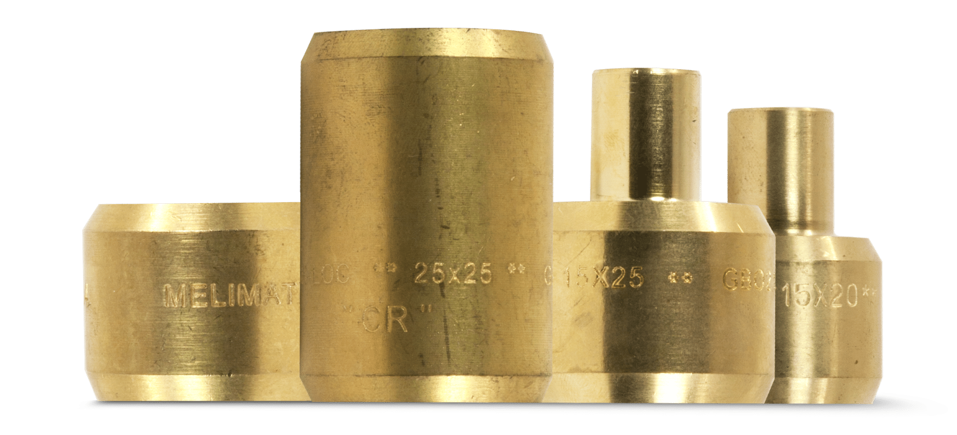

Hi can anybody tell me how tight does a leadloc fitting to lead pipe need to be obviously not as tight as to copper as lead is soft plus is,there any tool that can trim the lead pipe down i know stanley knives are common but thought there maybe some special tool any help appreciated.
"Maximum torque 15 lbf ft"
Reactions: Aquarius and WC1
1. Make sure you have the correct size leadloc for weight of lead.
2. If you've space around the pipe why not a utc
Reactions: Aquarius
Shavehook or garden knife for cleaning / shaving.
Shavehook is easiest to use and cheapest
