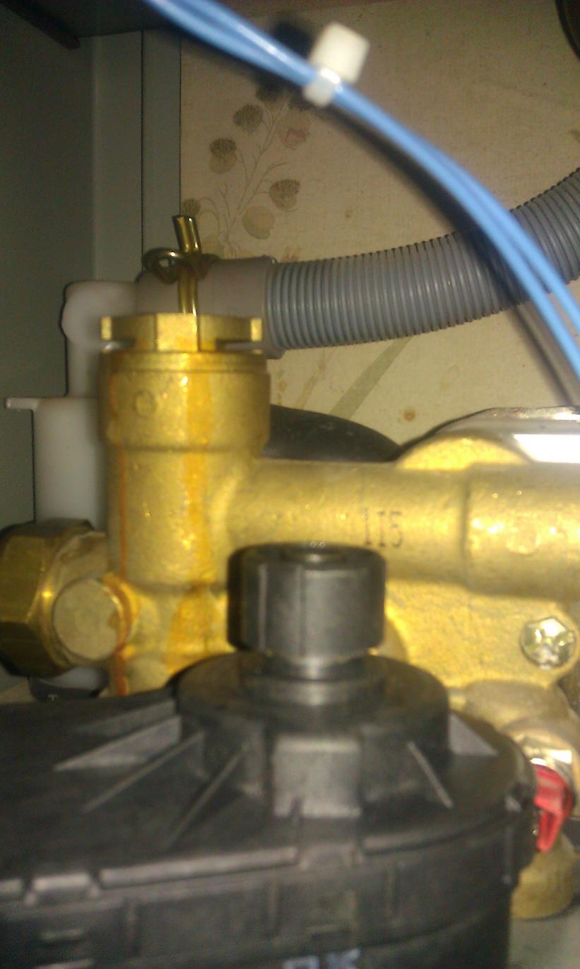

29 March 13 1172.jpg 29 March 13 1173.jpg These are two images after taking out the motor head from above the valve assembly. Should it not have an o ring somewhere or has it perished within a potterton gold combi 28 he? Anyone think an appropriate o ring would help.
The leak will be on the shaft seal lower down in the valve.
There shouldn't be water just under the motor
If youve got a decent o ring selection box and your desperate why not lift out the valve assembley and strip out the faulty o ring and replace it for now, youll need a new valve assembly in the long run as its probably clogged up but youll have a chance for some heating in the mean time
o ring is pressed into the bush if its a HEA you can buy a refurb section,IF ITS A he YOU NEED A NEW DIVERTER
its fun having a fiddle and living in hope, sometimes you get lucky and get things going until the new bits turn up, normally only bother to do it for old cold folk
Thanks to all of you folks, took the valve out and its one solid peace with no place for any o ring. It has just a spring loaded push rod for the micro switch.. great. Must be inside the damn thing so back to waiting game for a new valve.
did you ask for a replacement just for that model? im pretty sure most of ideals divertors are the same ie mini c28, logics etc even vokeras use that motor so the valve top(not the internals) would maybe be the same?? i would of taken the seal down to partscentre and compared them

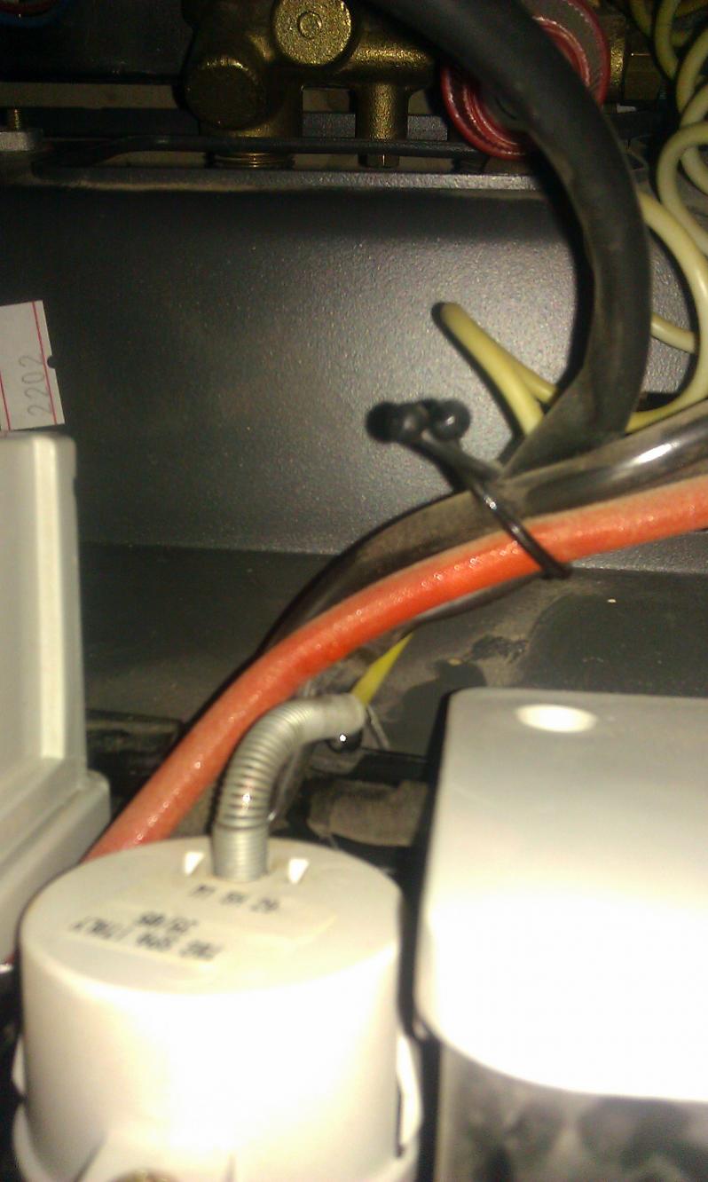

Good morning everyone and a Happy Easter. Got the valve assembly at one of the PTS stores and changed it. Now there is water dripping (slowly) from the back of the pressure gauge. Anyone come across this before and importantly any solution or do I really need to wait till Tuesday for some more spares. Many thanks to all again.
by the looks of the photo youve snapped the tube, ive never repaired one. stick a bucket under the boiler if its just a small drip get a replacement
