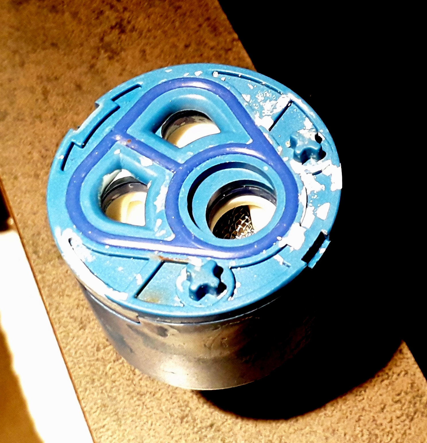

When talking about o-rings I'm not sure of the terminology - like I said the only visible is one (gasket, perhaps) with 3 openings. I'm including a photo with contrast turned right up (an old one complete with limescale) - I hope this doesn't affect your thinking - The new ones came complete with rubber gasket in its recess.
With seeing the new I cannot comment further.
I can however tell you that the old cartridge is a quailty item. Most sold online today are nowhere near as good as this one.

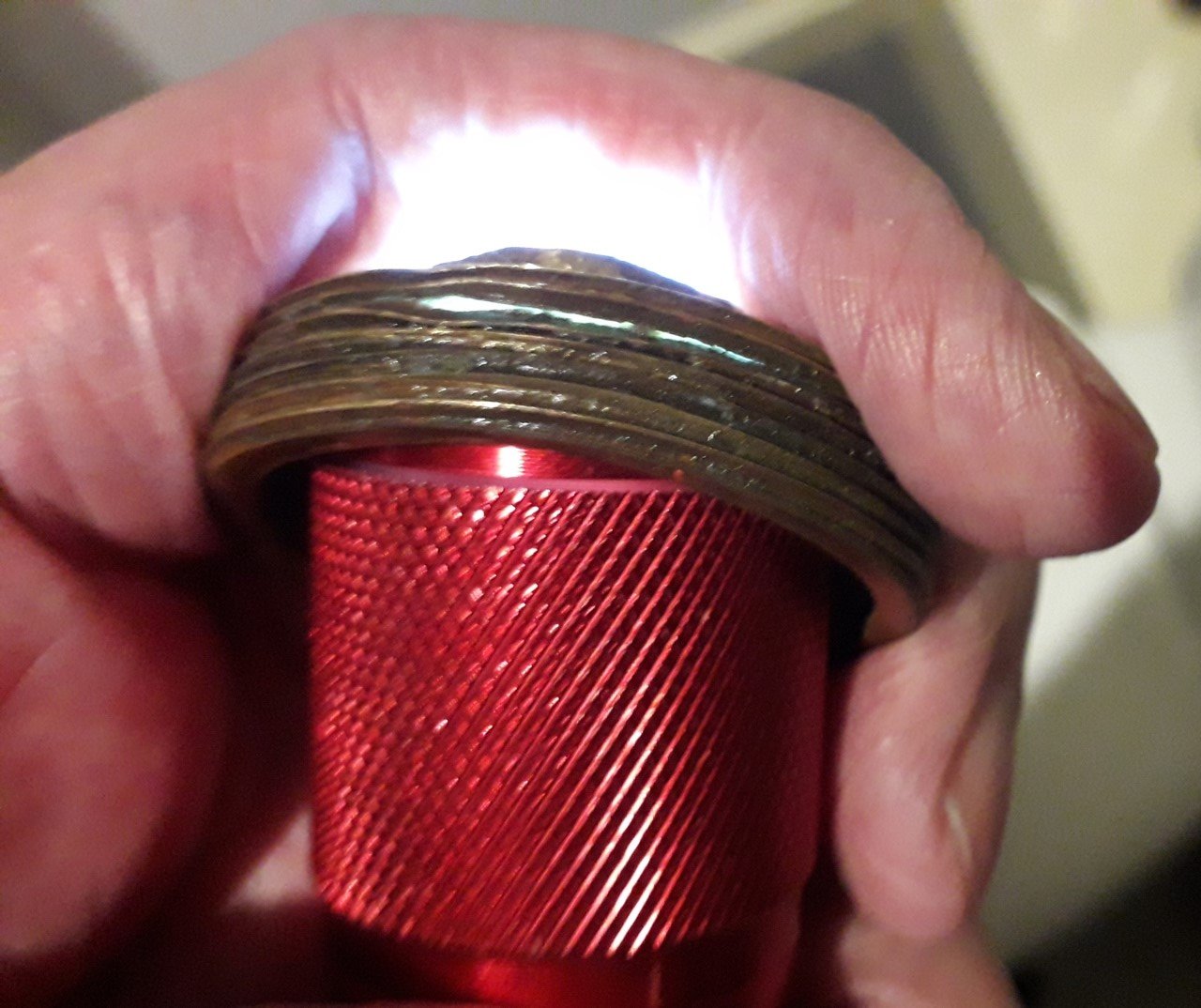

I've not been around for a while and just wanted to thank everybody for their contributions. I now have 1 tap that refuses to stop leaking, but the attached photo should explain why!
Having prepared myself to email the manufacturers and parts people etc. I googled "spare parts for taps" - the first link was to Ebay and their first listing had a photo I immediately recognised for a 40mm top nut and cover!!!
I'm expecting it soon and have fingers all crossed.
cheers guys, Phil.
