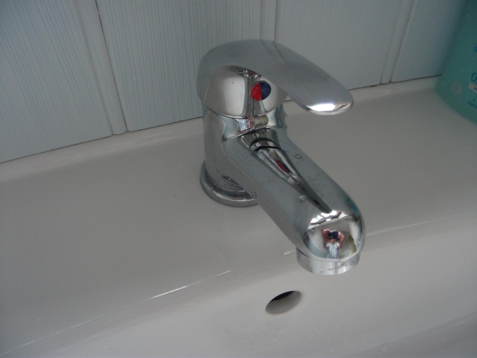

Good Evening, I've recently fitted a new monobloc mixer tap to the wash basin in the bathroom however when i turn the tap on water slowly leaks from the top of the tap. I've tried reducing the water flow to the tap but it doesnt seem to make any difference. Any idea if this can be rectified, thanks

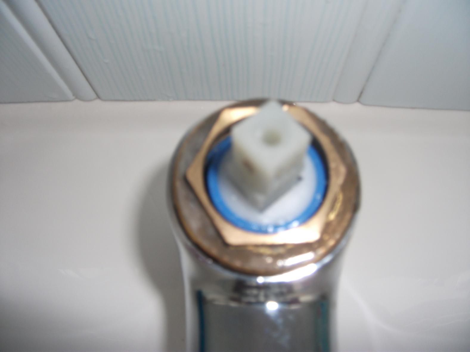

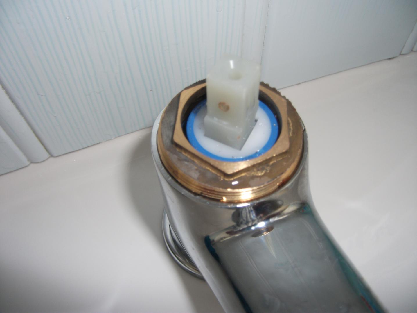

I've taken a few photos of the tap assembly, the water is leaking up from the square in the centre, i've tried tightening the brass nut but it has not made any difference DSCF2163.jpgDSCF2162.jpgDSCF2161.jpg
Thanks for that Steve, can you advise what the cartridge is and if its a part i can buy in a local diy store like B&Q
Thanks Phil, Can the cartridge be replaced with the tap in situ without disconnecting any of the flexi hoses from below as access is very, very limited and the basin needs to come off the wall if any attachments need to be disconnected
Turn water off and crack open the brass nut you'll need decent grips or adjustable and remove cartridge.
No need to mess underneath.
Thanks again Phil,can you tell me which part of the cartridge I am measuring to determine whether it is 35 or 40mm
Hi, useful thread thanks. Mine was a similar internal leak, on a BRAND NEW Kadya MT3006 basin mixer. This new one just had the large top-nut a bit loose, and was allowing water past the bottom seals (between the cartridge and the internal centre "floor" where the outlet ports line up with the bottom of the cartridge). The thin blue seals are only just proud of the cartridge base, so need to be pressed well down by that retaining nut (in this make anyway)!! The water can find its way out via the small locating holes for the base of the cartridge, and these holes are just "open" to the hollow tap body (hence water can leak from the bottom of the tap - hard to spot unless you have a small mirror and torch handy). Strangely enough, the new one is replacing a 3 year old one of the same make and model, with a very similar internal leak (but that one has an older design, with a slotted ring, rather than a 22mm HEX - and a special tool is needed to remove it). Thanks for the useful link too, very useful for spare cartridges.
