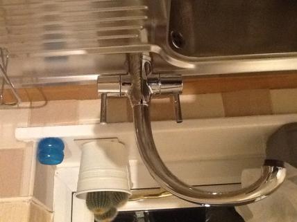

After many weeks of our kitchen tap leaking i have decided i need to address this sooner rather than later but am a bit reluncant as i dont want to make the issue worse than it is.
We have a kitchen tap from the manufacturer blanco which has seperate controls for hot and cold. I believe the correct term maybe twin lever tap?
It is a leaking but I am unable to understand whether its the cold or hot section is affected. From doing some research on these taps i understand its not just a washer that I can replace but it is a whole valve unit.

Simple test to determine if it's hot or cold. If it was installed correctly, On each of the 2 pipes that feed the tap there should be an isolator valve. Simply turn one through 90 degrees, if the water drip stops that's the one. If not turn the other and if that stops the drip it's that one. Blanco taps have a good long warranty so you may get 2 valves for free. If not they will be about £30. You will need tools to replace them, search you tube for how.
