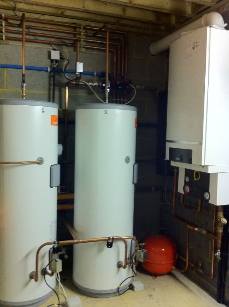

HI, i am looking to install 2 250 ltr cylinders in one dwelling which will be heated by 2 30 kw system boilers.
I was just wondering what is the best way to link the whole lot together?
I have fitted single systems before but any advice would be great thanks.

A zone valve on each one , hots connected at the top together , look at mega flow website

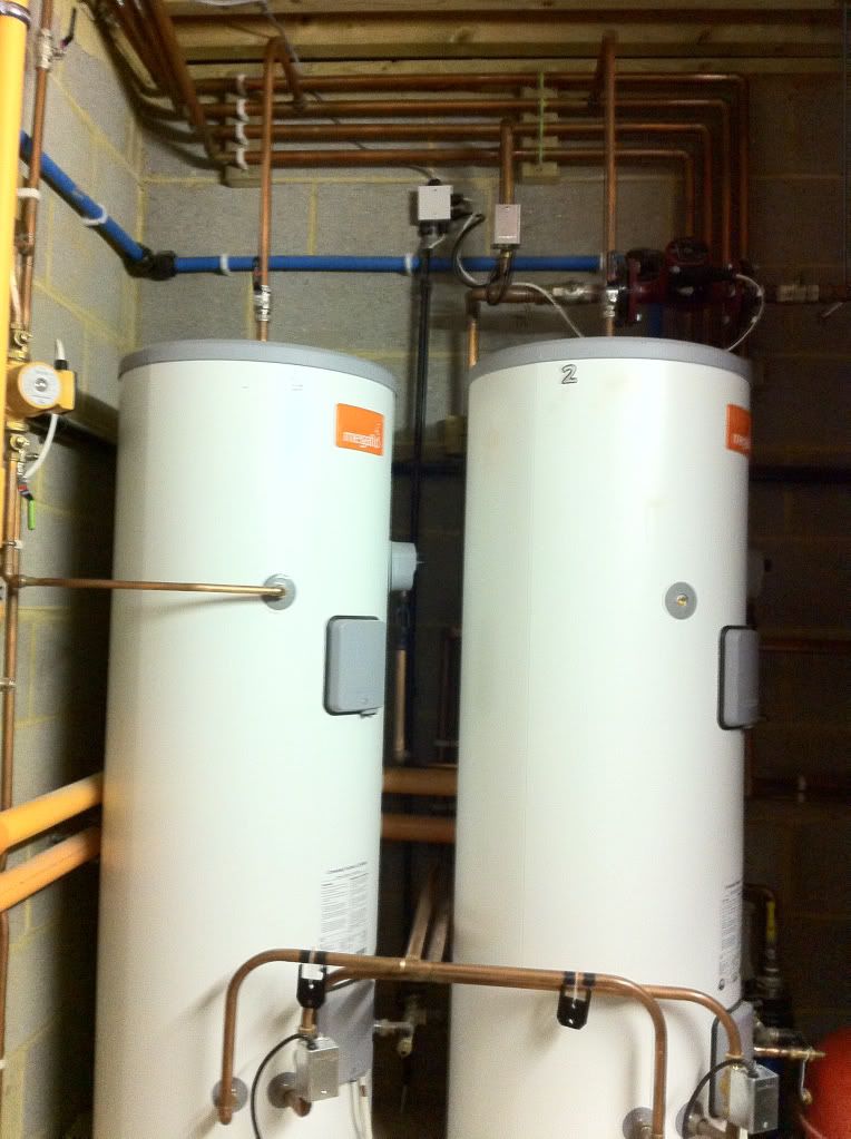

Ok i will take a look, i did think that but was reading something about the secondary return going into the feed of the second cylinder to prevent stagnent water
The secondary return should be fitted with a non return valve at the cylinder dude, as for linking the two, the photo I posted earlier clearly shows. It's pretty simple.
Yea the secondary return is the 15mm pipe entering the 1st cylinder on the left,
pill see if I can find a better pic.
