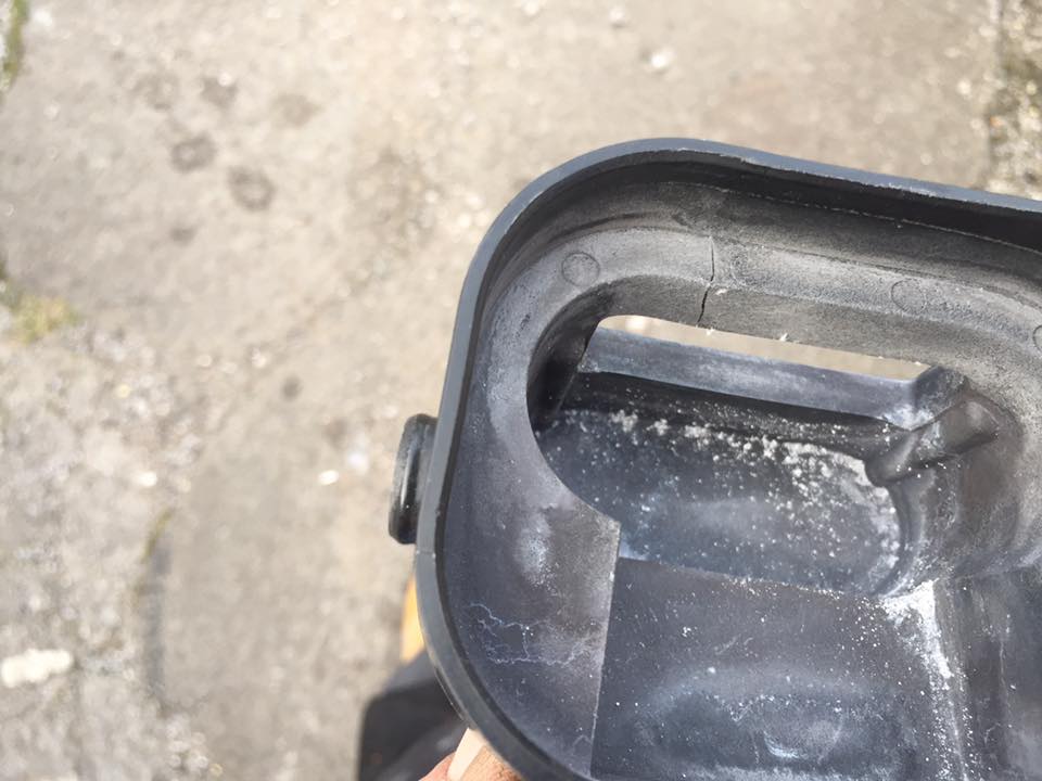

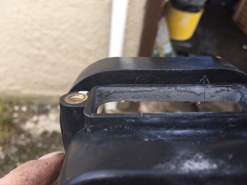

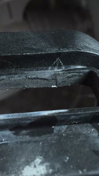

Just an update on this, have been called out to the offending article yet again! Display as dead as a parrot in a Monty Python sketch, nothing, nil, nada, niet, non, etc, 240 to the main pcb, no sign of any damage to board or ribbon. Signs of water, in the front right hand side of boiler case underneath the the pump, but no sign of where it is arriving from.

Crack sump and leaked onto something electrical?

Water could be from a cracked sump,post some pics up in a bit,is it brass hydraulics or plastic,and welcome back

just also like to say thank you for the pics Gasman, really appreciated!
