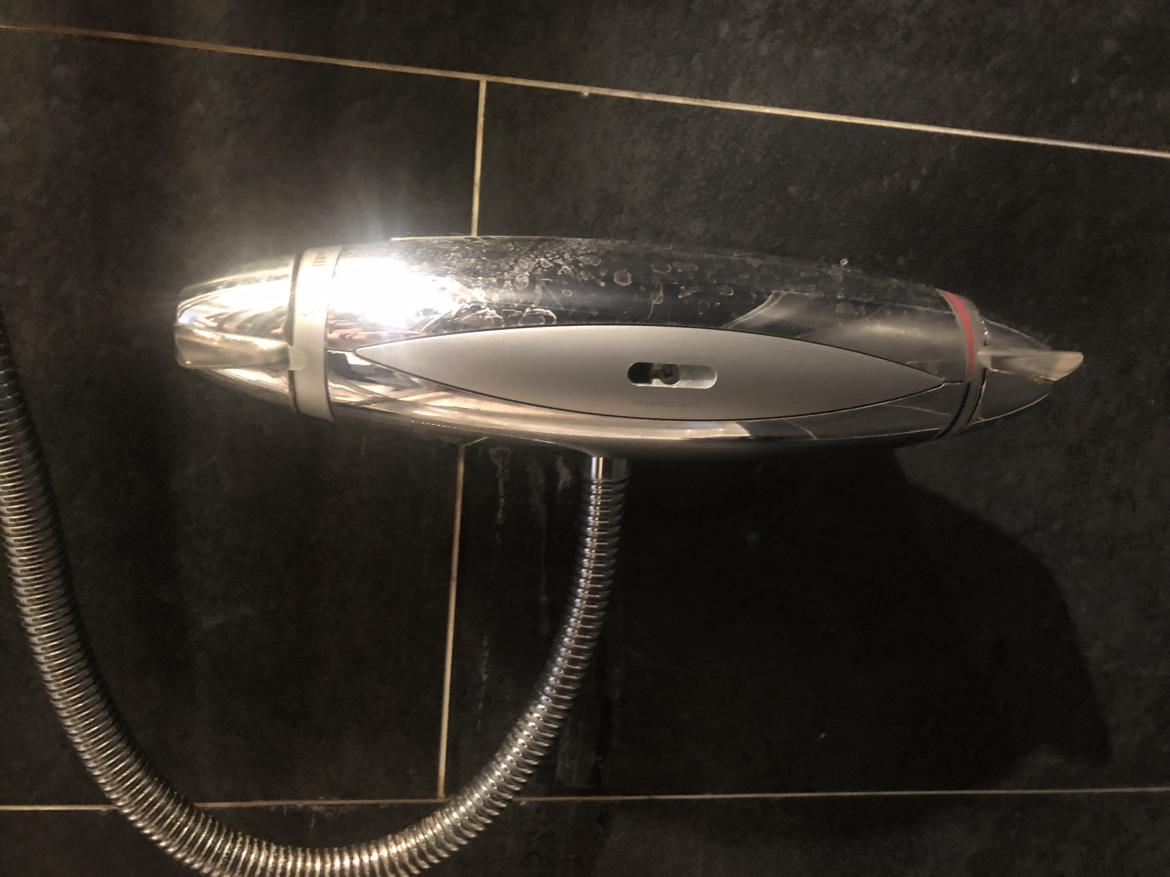

Have you not had the shower checked yet?
