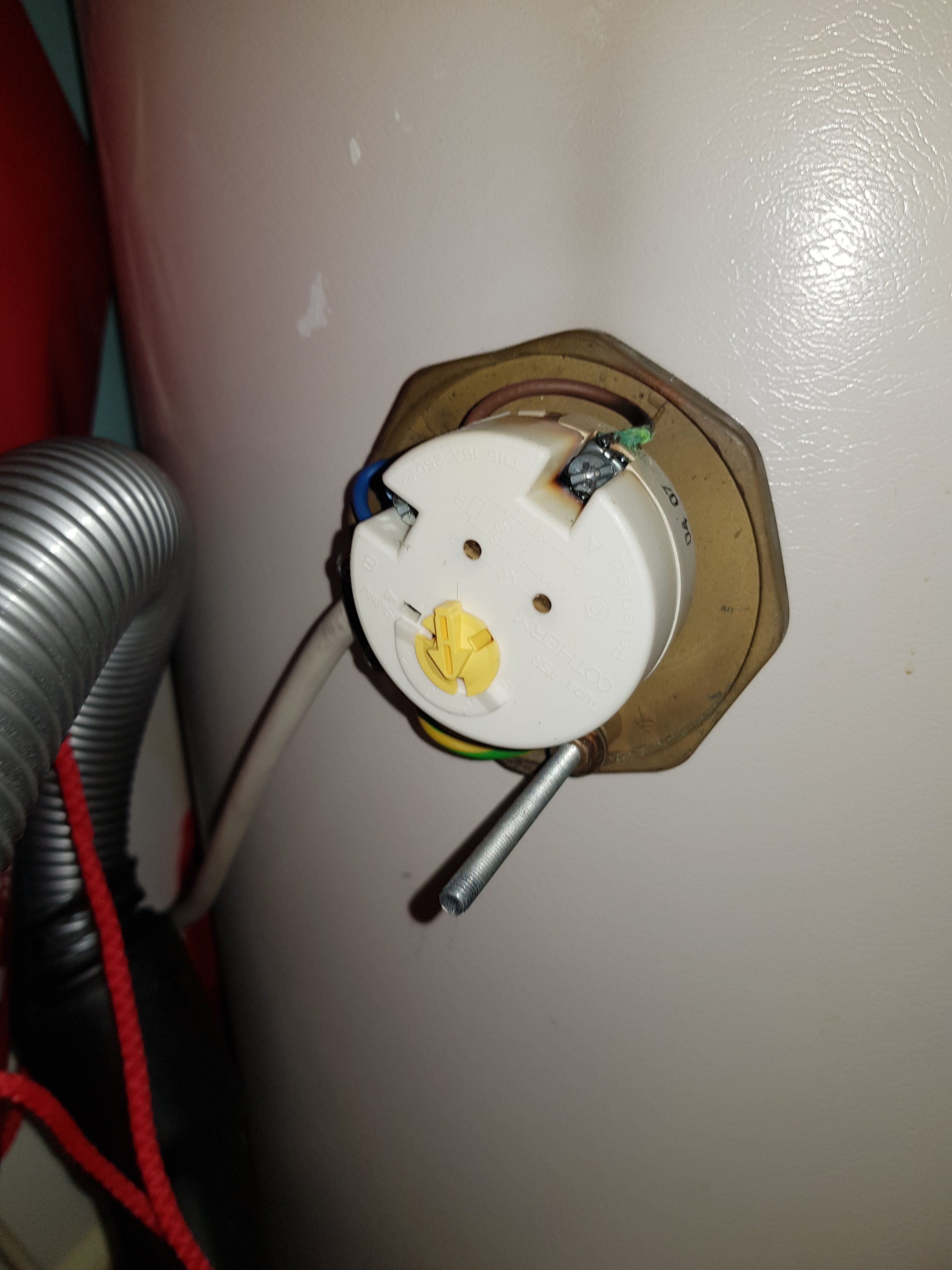

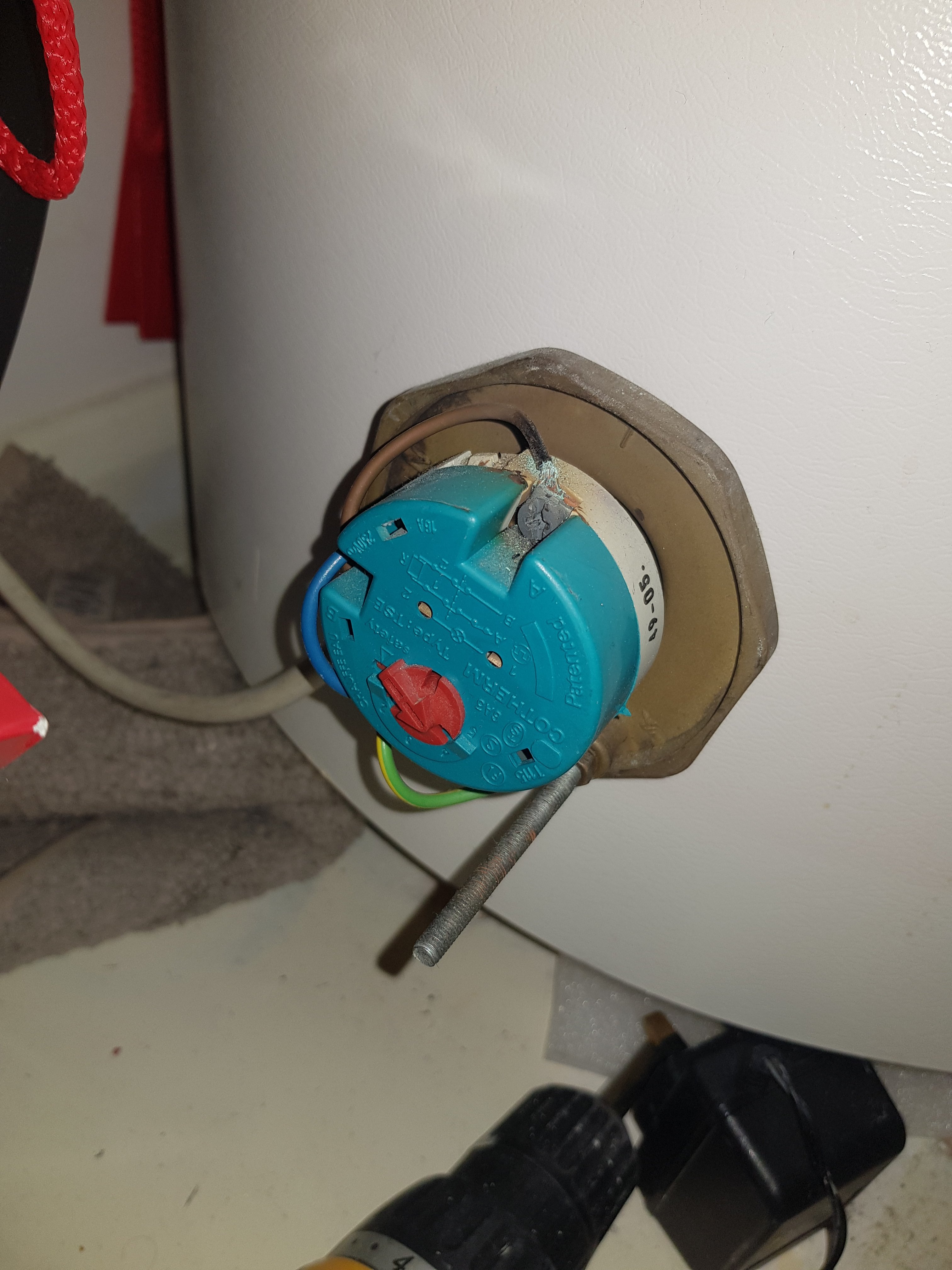

How have you checked the thermostat ? If you have done it by “ clicking it “ like most , its not accurate.
Post a pic of the stat , most of them are garbage.

Thanks, you were right about the thermostat both seem to have blown, the upper one is holding on for dear life but needs changing.
It hasn't been serviced in a while either so the engineer said it may be worth descaling it too. He has quoted me £200 to change both thermostats and descale. Does this seem reasonable?
