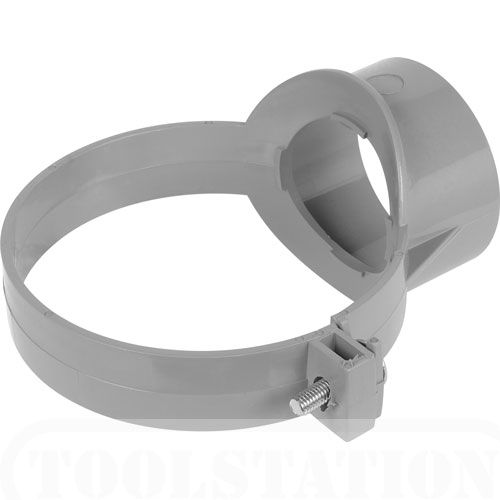

Maybe I'm being daft but that needs to be solvent welded? These metal ones have a thread sticking out of them where the nut screws onto so I don't think I can fit a boss anyway. Thanks though
