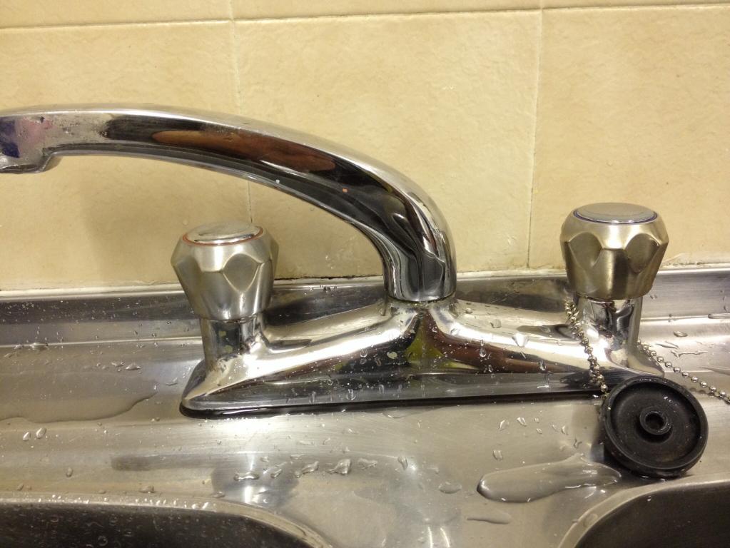

anybody got an idea for the maker of this mixer, don't think tap tops are original, it needs new o rings for spout, can't replace taps due to being fitted made up and all pipework is hidden.
cheers

Going to have to I think. Just didn't want to make several trips
They are a nuisance. I take a few boxes of assorted O rings with me & as above post says, take the spout out & try my luck. You don't want to use a slightly too big O ring as the neck will seize after a while.
