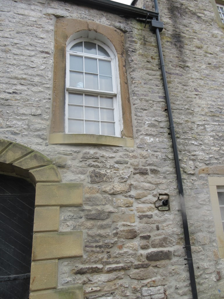

have one more Q-when the engineer came to have a look/ commission he said we'd need a plume management kit for our boiler. My Dads a former gas man (retired a couple yr) and he thinks one may not be needed...so we have a difference of opinion. As building is listed its preferable not to have one and cost implication but obviously it still all needs commissioning. These are the measurements: -Flue is below / to right of window-top of flue to top of window sill is 1.14m and actual window opening is another 3ft above sill.
pic-below
Ok thanks-should they be able to commission then as the plume management kit was the only thing they said was stopping commissioning?
