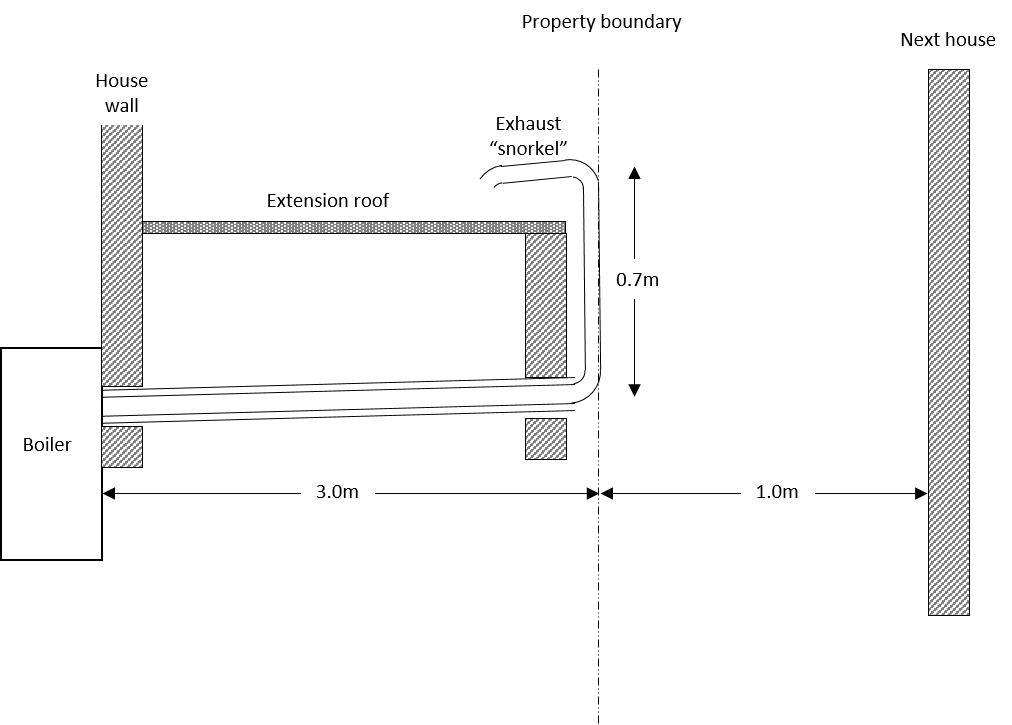

Hi. Our builders hit a problem with extending the balanced flue through a new extension. Their solution was to have the outer, intake pipe terminate at an external wall, but add an extra section to the inner pipe to take the exhaust away from the next house. However, the gas boiler was repeatedly shutting down and they have had to remove the extra pipe for now. The boiler is a GlowWork Flexicom.
Can anyone answer these theories as about why the boiler might be shutting down:
1) The inner and outer pipes should end at the same point
2) The extra pipe has two sharp bends, which is causing extra resistance
3) The weather is very cold, resulting in excess condensation on a 2m external run of flue.
Any other ideas gratefully received.
Many thanks in advance.

Thanks for your replies, everyone. The bodge arose because the planned vent through the extension roof was not possible. We think we have a better solution now, but will take up your suggestion of getting 3rd party qualified opinion. In the meantime we would like to dispute the installation I have sketched. Further research tells me that the inner and outer pipe ends need to be in close proximity and the sketch shows significant separation.
Should never really be coming out so close to your neighbour. Plume management kit does alleviate some of the nuisance. Poor planning. Why can’t it go up through the extension roof. Would love some pics. And also don’t box it in without inspection hatches. I don’t believe a gas engineer would run it like that given the choice. Seems like builder playing gas man to me. Don’t wait until it’s all finished before you get it checked

There should never have been any attempt to fit the flue facing the neighbour if it's so close to the boundary, suggesting it's not been planned by a GSR.

@Riley You mention the flue been too close to the neighbours property, but am I right in saying you shouldn't terminate the flue within 600mm of the boundary which it looks to me like it is.
