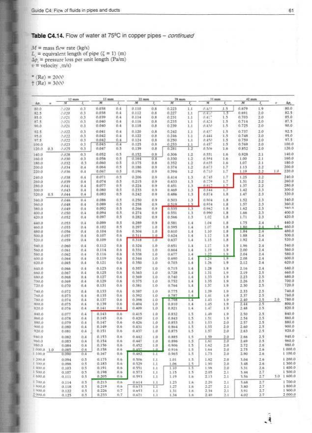

take at Look:
These are CIBSE water flow rates and you can work on the basis of constant velocity, constant pressure drop or just ignore them both and work on mass flow rate
and read off PD and still look at limiting velocity in the stepped bands. You have the best of both Words all based on water in pipe at 75 DegC, there are correction factors for different temps
but you are going to be cracking very small nut with a very large sledge hammer, doubt if that is needed on UKP

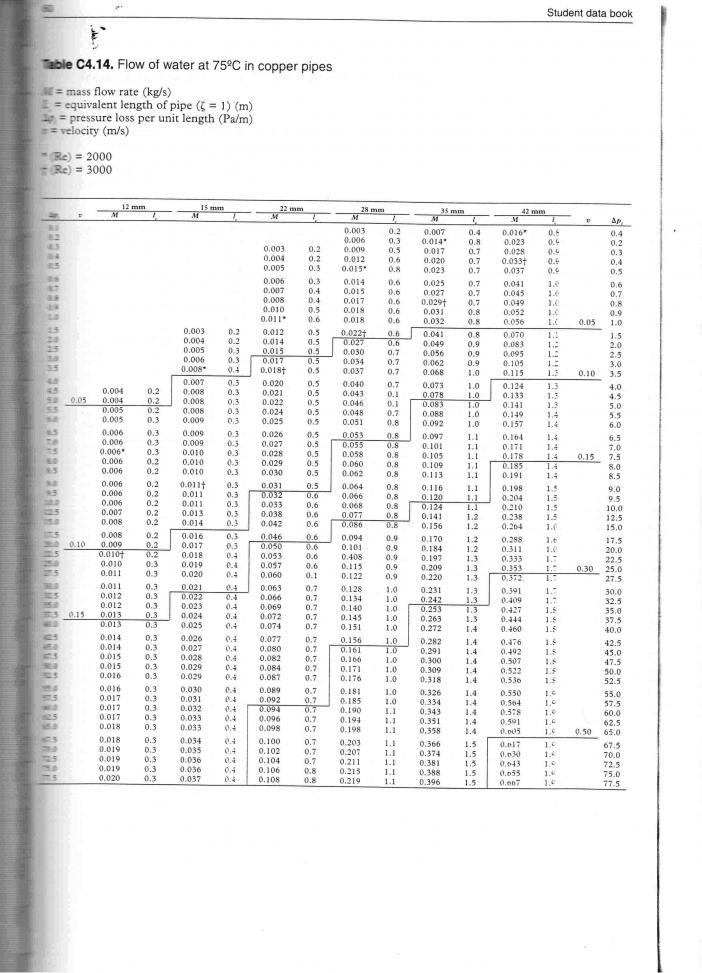

I suggest you take a look at the same table. The flow rate of 0.205 l/s is for a velocity of 1.5 m/s not 1.0 m/s. The table does not show the flow rate through a 15mm pipe at 2 m/s.
How right you are, me at 5 am must stop posting at that time, nice one, nice colouring in too, colour scanner, woow, and like I said you won't find me designing down the bottom of the page at those high velocities, 0.5 to 0.75 is fast enough
