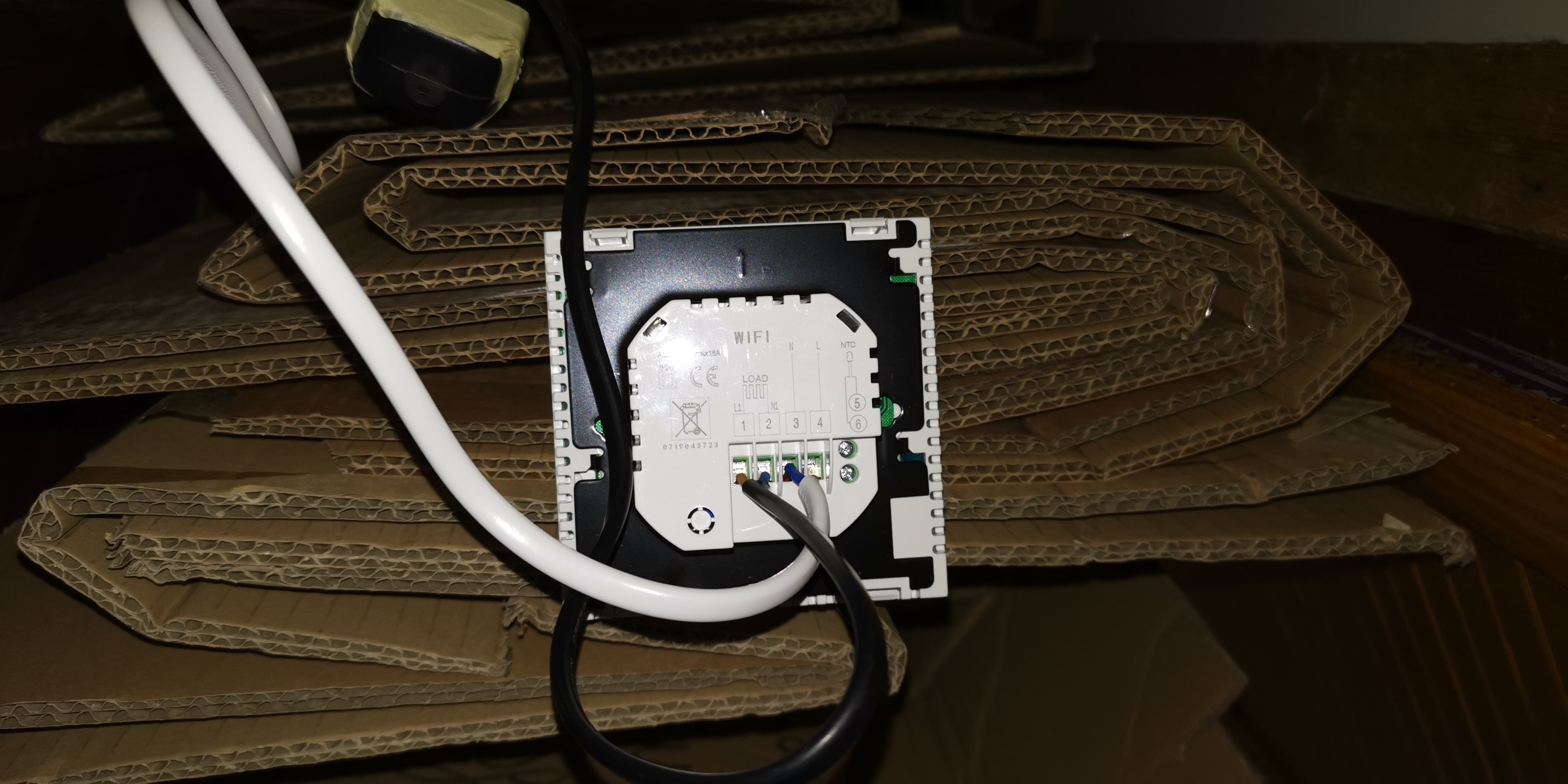

The house I've bought came without a room thermostat. Just a combi boiler with a timer. So I bought a room thermostat, installed it, but it doesn't turn on the heating. Here are some photos to illustrate.

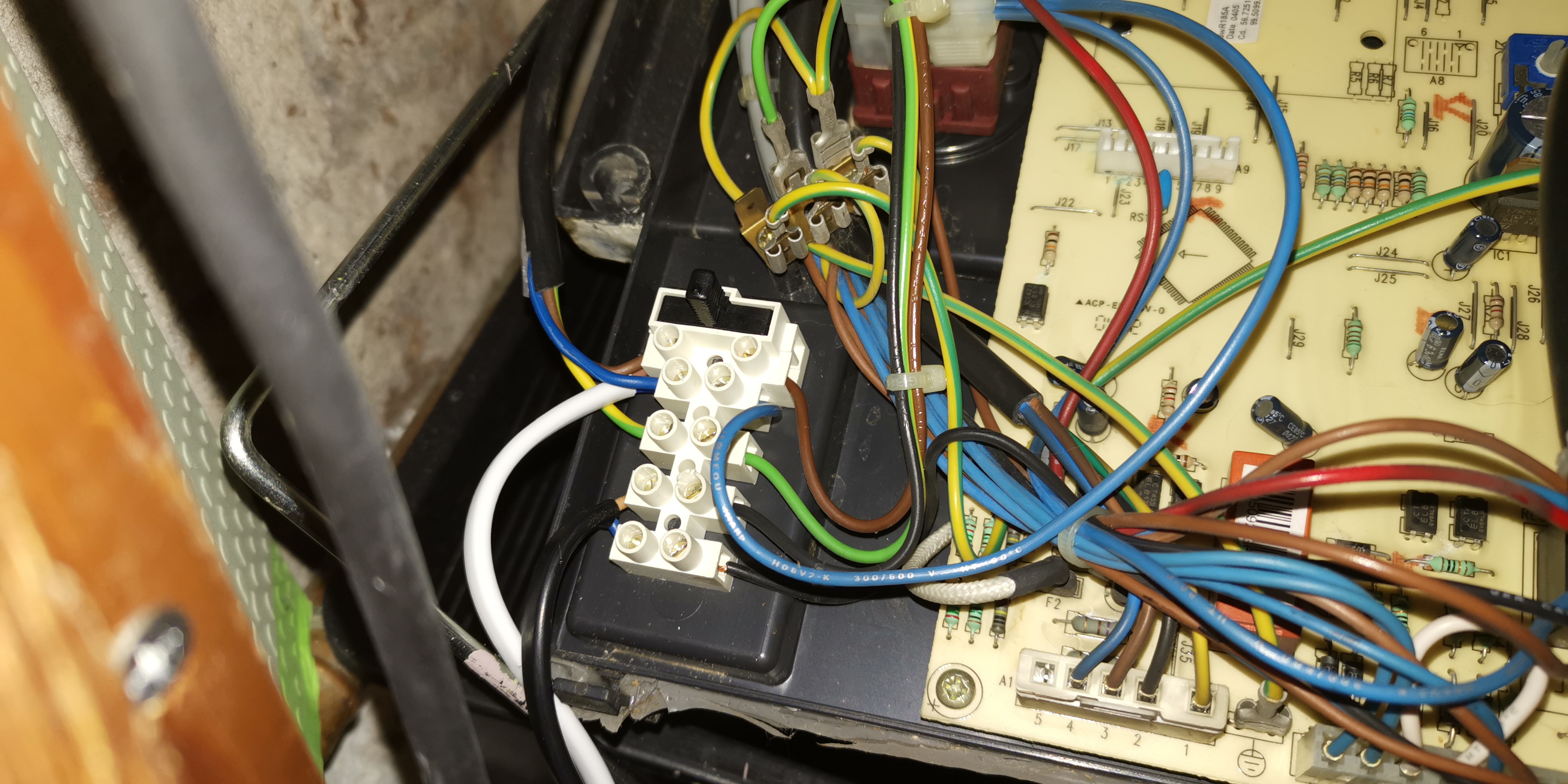

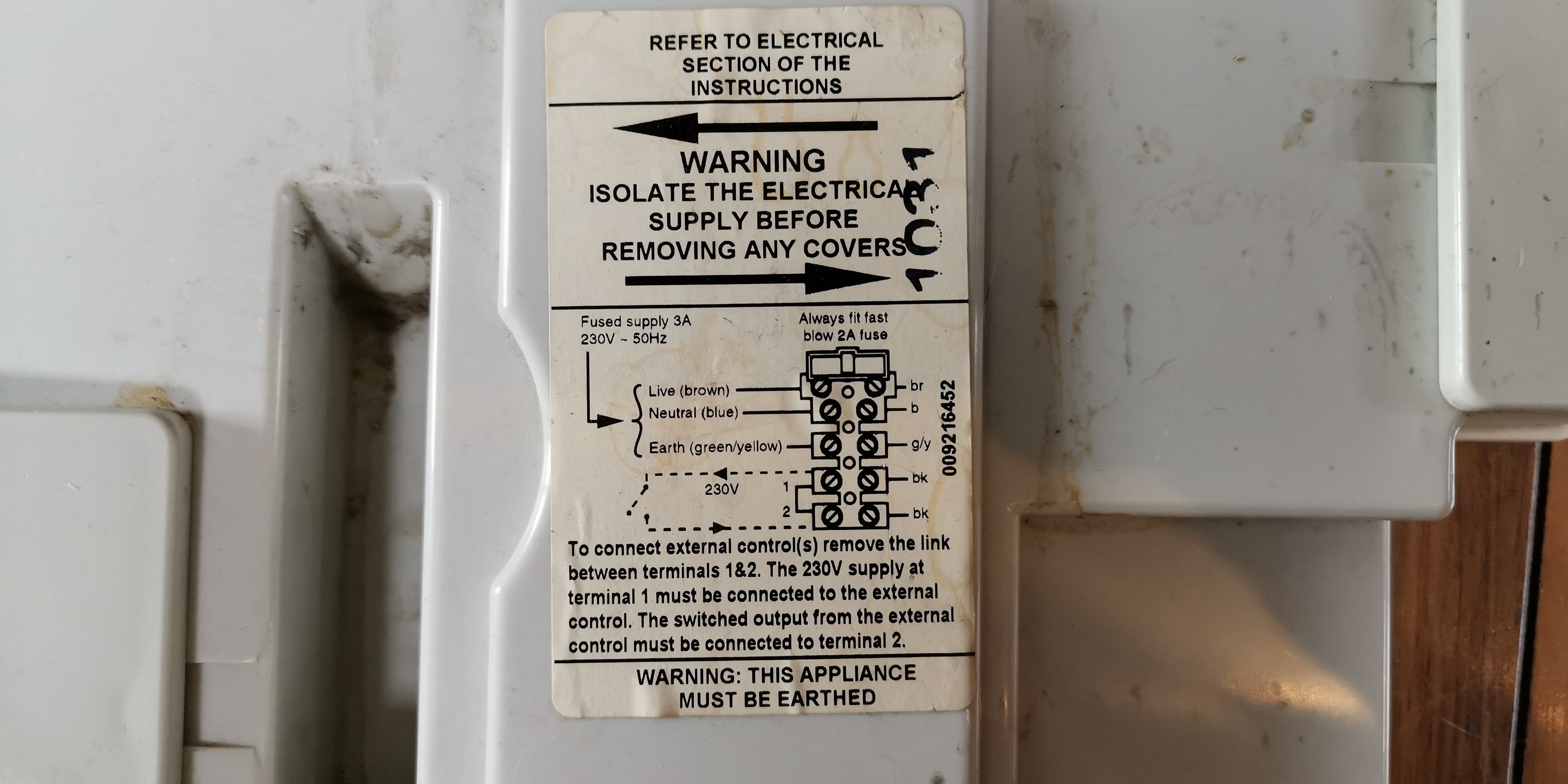

So as you see I've piggybacked of the Live and Neutral input from the boiler to power the thermostat (the white cable). The black cable connects to the 1 and 2 on the first diagram.
When I turn the power on, the boiler powers on and the thermostat as well. When I increase the temperature on the thermostat I hear it click, but nothing happens.

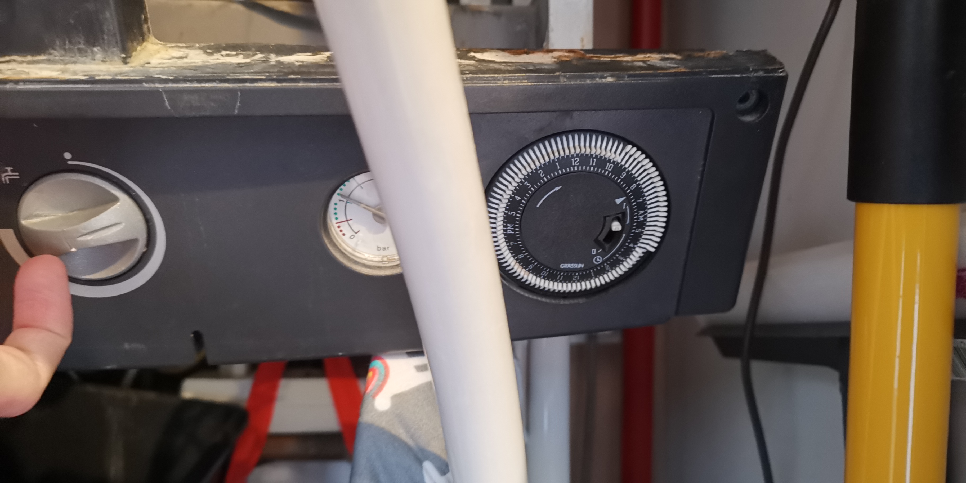

I also have one of these timers:
I've tried every setting on it, nothing works.
