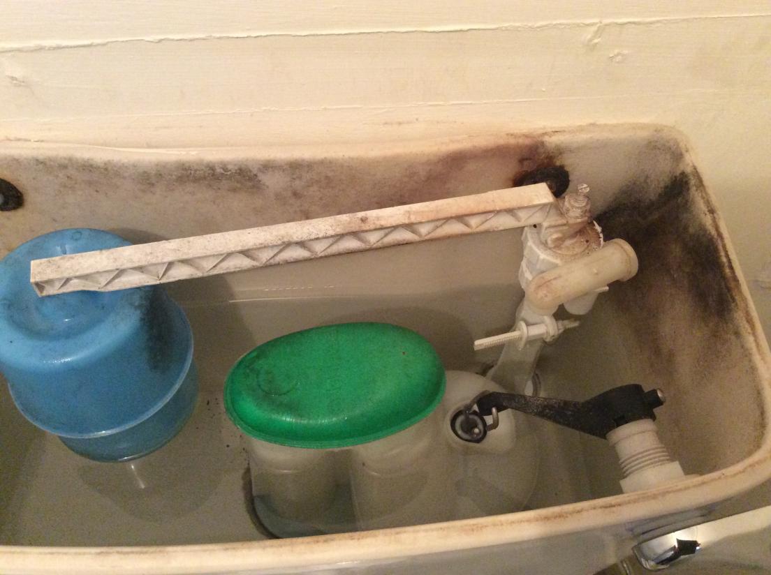

Thank you Steadyon. I've posted a picture on the unit below - sorry for ignorance, but I guess the washer would be on the right-hand side, underneath the arm, where there's a bit to untwist? I did try undoing it yesterday but it was very stiff and I was worried it would break. Would you recommend a particular tool to help get leverage on it?

Lyou will cure that balvalve without taking it out.
There is a threaded bar, just above the water line. This needs to be touching the side of the cystern. That will stabilise the valve and stop the water hammer.
Tracy if your gonna replace it I would recommend a fluidmaster pro 45b fill valve as there is lot of room in your cistern for one. I change your type all the time sounds like a fog horn on a ship at 3am when you visit the loo waking the whole house up

That old ball valve you have is certainly fixable with a new standard part 2 diaphragm washer. But the large nut being horizontal can be a bit awkward. I have used a basin claw grip on the nut just below the large nut to remove the top of valve to work on it. Needs the bolt support touching the cistern as said.
If you have mains water supplying the valve and of a decent pressure, then that valve isn't very suitable IMO. As above post says, fit a Fluidmaster Pro 45b that has a brass tail.

Thanks everyone for your excellent suggestions. I'll try moving the threaded bit to touch the cistern first and see if that works. Really appreciate you all taking the time to help!
I don't think moving the arm will help, easier to replace the valve for a permanent fix... depends if your good at DIY tho
Looking at that cistern I think a fluidmaster float would catch either on the sides or possibly on the syphon, the inlet hole is really close to the edge, something like a flomasta with a guarded float might be best.
Totally agree that a fluidmaster should go in if possible, but that looks pretty tight.
Thanks everyone for all your kind help and advice - pleased to report that I fitted the new ball valve this morning, all fine, easy job and took me less than an hour from start to finish, including reading and re-reading fitting instructions and having a cuppa midway! Chuffed that I did it, thanks to your good advice :wacko:
