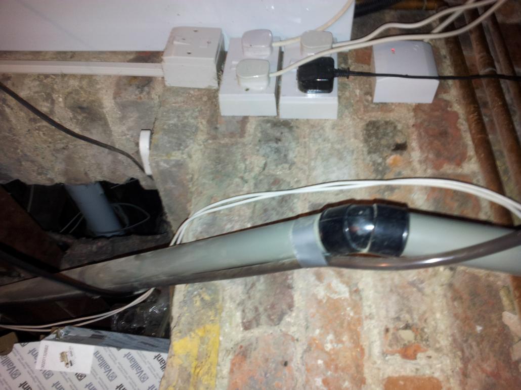

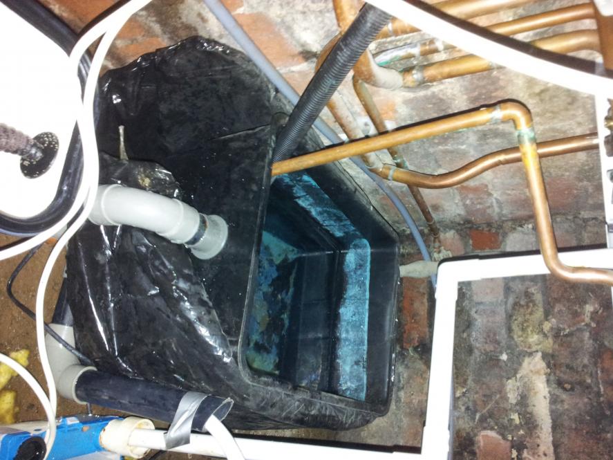

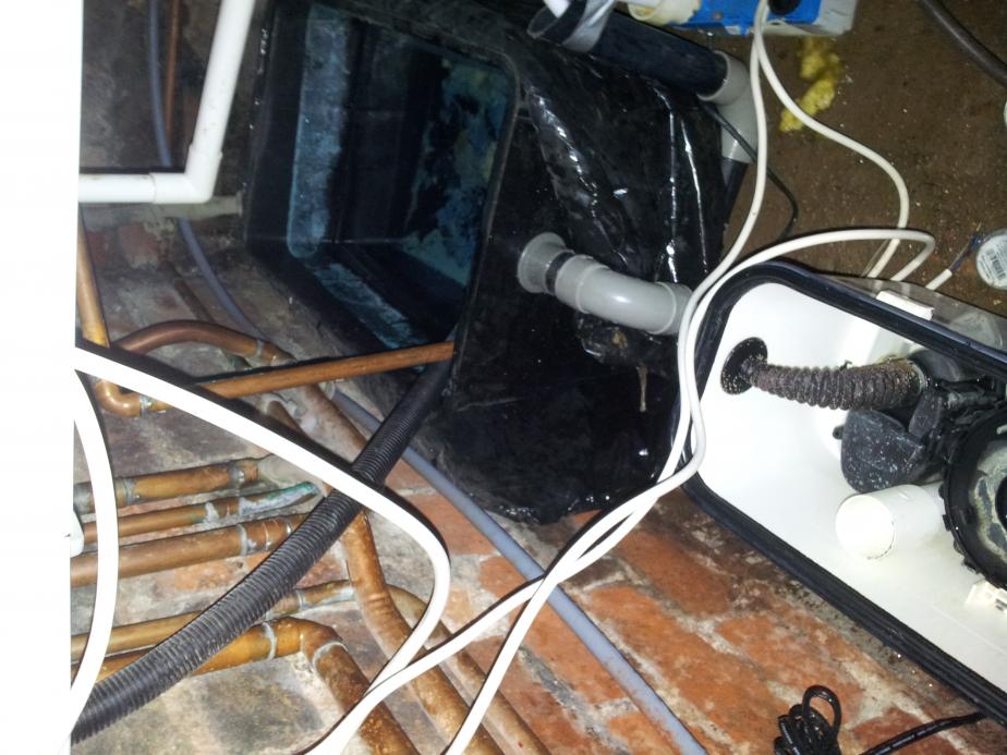

vaillant 937 (the one with 20L of stored hot water)
its in a basement and the engineer has put a pump in for the condence, so far so good, but for both blow offs he's put an 18L tank under the boiler, then a waste pipe entering the tank at high level, the waste pipe goes to a macerator where any water would be pumped out
going to phone vaillant monday but this set up seems wrong (particularly now the macerator knackered) I've heard of PRV being attached to rads but I dont think a vaillant 937 is suitable for a basement install

Don`t know if this will help you but the little condence pump in picture 2 look like a Sanicondens plus which is ok to deal with the acid condensate (if serviced yearly) because it has a neutralising tray and the pump in pictures 3 & 4 is the Sanivite (not a macerator, no blades) which isn`t suitable for acid condensate. The vite will pump vertically 5m and horizontally 50m if installed correctly ie one and only vertical within 300mm of discharge elbow and no sharp 90 degree elbows in the pipe run. The vite could be knackered due to the membrane drying out and shrinking therefore the motor runs on continously.

I made a mistake earlier as the Sanicondens Plus doesn`t have the neutralising tray but the Sanicondens Best does and has the option of a remote alarm, it will deal with mean temperature of 35 and occasionally up to 80 degrees C with a minimum pH of 2.5. Maximum vertical pumping height is 4.5m but as with all pumps you don`t wanna be running at near maximum all the time.
I would replace the macerator, add a second tank, have the outfeed in say 40mm fairly low, stainless mech on the outlet, add a bag of lime chips and say you have to be the one to service the set up.
