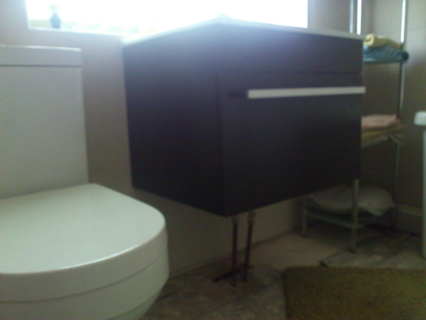

My version is I asked a plumber for a quote on fitting a new suite to an existing tiled bathroom. I only asked for him to remove the floor tiles because I was having a wall hung vanity sink and the previous bathroom installer, only 4 years earlier, had tiled the floor around the sink pedestal so this would have left an ugly gap. I didn't realise the plumber would also remove all my new ply sub tiling floor but he said it broke up removing the tiles. Unfortunately, this meant my new vinyl choice also needed yet another ply underlay...oh well...I would not have gone through with removing the floor had he explained this but he didn't and just took up the whole lot. He offered to come back at no extra charge £575 for 3 half days work as he already had other smaller jobs to fit in so he arrived each day just before lunch and left tea time on 2 days and only stayed a couple of hours on the Saturday. He didn't "fit" the toilet or the bath panel, and the several tiles he thought might need replacing stayed in tact all round the bath except for 2, and 2 mosaic ones where the bath was shorter. The tiling was in the price, but whilst doing the job (4 tiles) he said he hated tiling and would I like to employ a tiler! He begrudgingly carried on, though he was delighted I had paid extra on delivery of the suite for all items to be carried upstairs for him.
However, when I went in the bathroom to inspect the progress I was dismayed at the pipes on show beneath the new vanity unit! Had I known in advance I would have a) like a quote for re channeling the pipes. b) send the new vanity unit back intact and paid for a standing one.
At this point the plumber changed personality and started accusing me of thinking he is a charity and that as the customer, I should have been aware that such pipes were obscured by the previous pedestal. I stated I would have expected an experienced plumber to be aware that on giving a quote it was his job to survey where the water supply fed from and that leaving the pipes where they were had defeated the object of my having the floor taking up and that he had now damaged my new vanity unit by making (not that neat) holes through the bottom of it. I could not now return it.
He now says he can refit the pipes (LOOK AT PICTURE ABOVE) a few inches further back QUOTE "out of the goodness of his heart" and a "Gesture of goodwill" BUT that he will now charge me an extra £40 to secure the toilet and bath panel.
He says I am a poor communicator and misunderstand everything he says and it is my fault I did not notice the pipes in the first place.
Comments welcome. I have tried to be as objective as possible, but to be honest, every time I see the guy now I get palpitations.
I said he could refit the pipes but I would solve the fixing the toilet and bath panel myself after my new floor has been installed.
Am I unreasonable feeling the pipes are unsightly and unnecessary as part of the job?
PS, the sink looks huge but it is deceptively much more in keeping that it looks, though the pipes aren't.
I've had a few glasses of vino, but yes that does look rather ridiculous. Regardless of possible communication issues, as a plumber I would have expected your plumber to have pointed out the fact that you would have two unsightly pipes on view.

re plumbing, not good, could be tidier and tucked away. overall lack of communication in both directions here, did you get a written quote and spec of work involved, if not you are partly to blame as is he. its no win really and stress all round. try my suggestions first and take it from there.
It is hard to tell from the pic, but if the wall is plastered and not tiled, I can see no reason why the pipes were not placed in the wall.
technically speaking this is down to communication between you both. He should have discussed the pipework with you before starting the job imho.

I am friendly with my ex who isn't a plumber but is gifted with a technical eye and even he says he would have removed 4 tiles under the sink and channeled the pipes in the wall but you might laugh when after having "qualified plumbers" to do a £7000 bathroom in our old house and after 3 major leaks, my ex improvised by refitting the bath uses car radiator hoses and we never had a leak again! he also repaired the Mira shower with a few carburettor bits he had in his engine tuning van. Anyway I digress but thought you might be amused.
Honestly, the work is crap. BUT we only have 1 side of the story and not all of the facts.
If this had been my job to quote, I would have advised that you should have got a floor standing vanity unit OR that to fit this thing to a decent standard would require ripping up floor, AND ply, to source pipes under floor and channel them back to the wall, but the chances are you wouldn't have liked that quote and gone with this guy who gave you none of the facts and charged you less.
In all honest there was not reason to take up any tiles, because he clearly hasn't modified the pipework and they look so bad just sticking up through the floor like that, that he may as well have just filled in the spot where the pedestal was before (this pipework would look worse than the infill). The basin also looks too high to me, what does it measure to the top?

No, although the pic demonstrates the pipes well, it has distorted the image of the sink. It actually is really nice and right height. The plumber did think to ask on that point.

Having those pipes on show kind of defeats the object of having a wall hung unit. Now it needs boxing in. Disgusting job.

Generally, with wall hung units, I would expect the pipes to be hidden away, and personally I would have raised the issue with the customer at the time.

A "real" plumber would have looked at the original set up and pointed out the steps to making this a really good job not necessarily outside the stated price. Sorry that you are in this situation but it will take a little more than the withholding to make good.
This has nothing to do with communication.
Any half rsed plumber would have known what to do to leave a decent job. It is lazyness and incompetence.
Stuff like this does my nut in.
Reactions: 5 people
Have to agree with Tamz, the job is rough and the fitter has gone for the quick, easy option. It is obvious that the pipes should not be going directly through the bottom, and even so, these pipes are not straight anyway! People like this give the rest of us a bad name.
I agree with the last couple of posts that this is poor workmanship. Regardless of the communication no quality tradesman would leave a job like this and should of made you aware of the situation, that's why you pay to get a 'professional' in.
