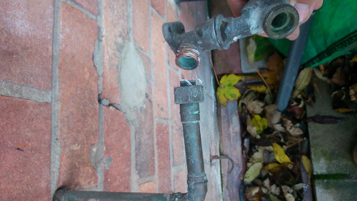

so the kitchen job that im on thats turned into a boiler swap and new bathroom in the new year,
I was asked if i could look at the outside tap that was fitted by a reputable plumber 2-3 months ago but is been dripping constant,
First off there was no DCV or isolation valve, not sleaved or taped through the wall, the pipe through the wall was made up of two bits of copper so a joint in the wall and then when you get outside this is what im met with, either we've been doing it wrong all these years or i need to up my prices for fitting outside taps if this is what you get for £50
:lightbulb: good news is the customer seems happy to pay for a bad job
then get someone else to fix it.:whatchutalkingabout
