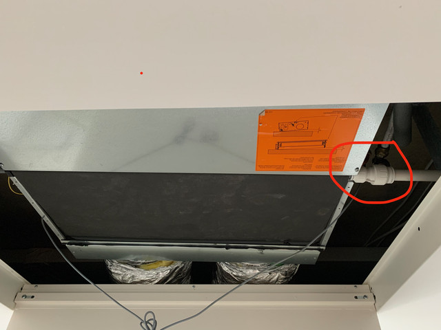

Complete novice here. I have water droplets leaking from the ceiling in both of my flat's bedrooms. It's coming from the exact same spot in both bedrooms, which is in the gap below where I believe the heating/air-circulation systems are located in the ceiling of each room (see pics below, the water is dripping from the black circled areas).
We do not have radiators, only fan heating from the ceiling vents which also has a "comfort cool" fan setting. The water is leaking whether or not the system is turned on in the room.

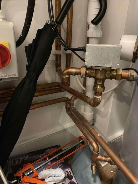

In the utility cupboard, some of the pipes are condensating so badly that huge puddles are forming. The floor feels so cold and some of the pipes are almost freezing cold to touch. I've put a picture below; the pipe above the towel is the worst offender.
Anyone have any tips or suggestions as to what this could be? Is it just a case of needing to insulate these pipes?

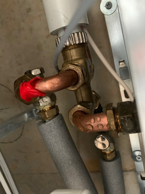

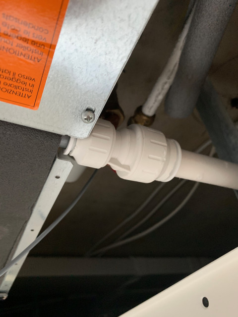

Thanks. I opened the access hatch in one of the rooms. The drip is coming from the copper pipes above this plastic pipe. They are really cold so presumably that is why they are sweating.
So, to try summarise my whole issue, it seems that suddenly my copper cold water pipes are running with much colder water than usual and that, coupled with the warm weather, is causing all these drips? Do I just need to insulate them better?

I haven't any experience with that particular type of insulation but yes, anything that will adequately insulate the pipework will dramatically cut down on the condensation. I just did a cylinder cupboard the other day because of this same problem. I just used standard 13mm tubular pipe lagging and it did solve the problem. These cylinders were in an enclosed cupboard so I also got the chippy to add a vent top and bottom of the cupboard doors to improve circulation which I believe also helped.
Hopefully someone knows the lagging you linked to and will be able to say if it's any good or not if that's what you want to use.
Great, thank you very much for your input. Do you think I need to worry about why the pipes are suddenly so cold?

It looks like you have a chiller system for cooling.
Best thing for this is Cork Tape.
Wrap it around the pipes and valve bodies loosely and then squeeze it firm.
You may have to do the condensate drain also from the fan coil for the first 1/2 metre or so.
The water from the chiller will be @ 12 C, so it will condensate when ever you use the cooling system.
