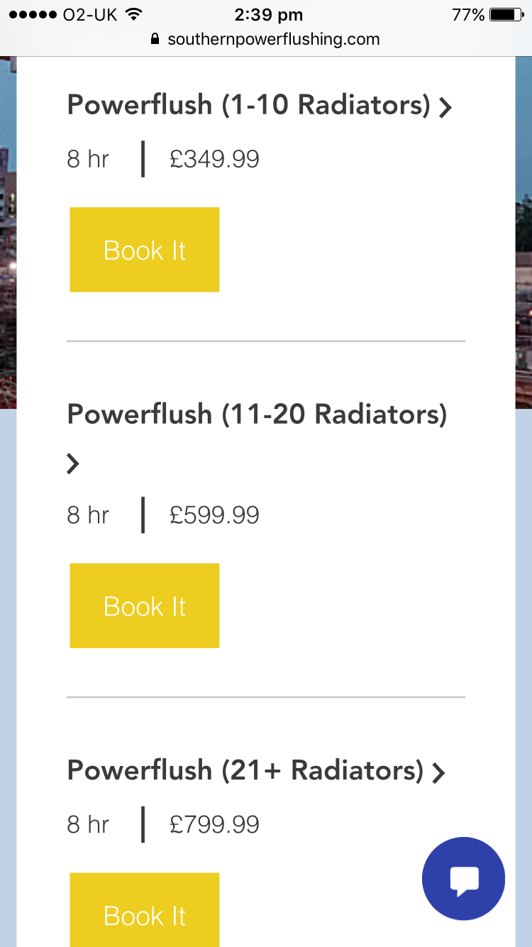

I find it funny they allow the same time for upto 10 rads as they do for 21+ good luck doing 21+ rads in a day
Yeah, true. They do say the allow up to 3 days per job. The booking system just books in one contractor per day (so they don't overwork/over assign us)
