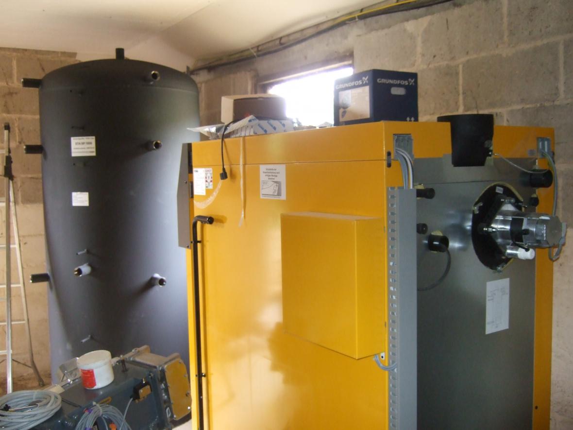

I have a 70kW woodchip biomass boiler installation including a 650 litre buffer tank, all installed in 2014. The buffer tank loses pressure from say 2.58 bars to 0.00 bars within a 48 hour period. Yet there are no visible signs of any water leaks,
When this tank is drained of water then pressurised with air to 2.40 bars the same pressure gauge mounted at the top does not drop. And when all of the joints etc. are treated with soapy water there are no visible leaks.
There was a similar scenario with a leg of 60m of highly insulated underground pipe that lost pressure when filled with water, but did not lose pressure when pressurised with air. When the air was replaced with water there is still no pressure drop.
It is thought that the system has been losing pressure ever since installation. We have yet to refill the whole system with water/inhibitor and turn the boiler back on.
Suggestions as to what may have caused this phenomenon, and any possible long term cures, are welcome.

The expansion vessel is 300 litres, connected directly to the back of the boiler. See photograph for pipe sizes. The expansion vessel is charged to 1.5 bars.

At the very top of the buffer tank the pressure gauge (see old photo) has been replaced with an automatic bleed.
The pressure release at the back of the boiler has not blown since testing during installation in 2014.

View attachment 27395View attachment 27396View attachment 27397View attachment 27398
Looks like an eta boiler and buffer
