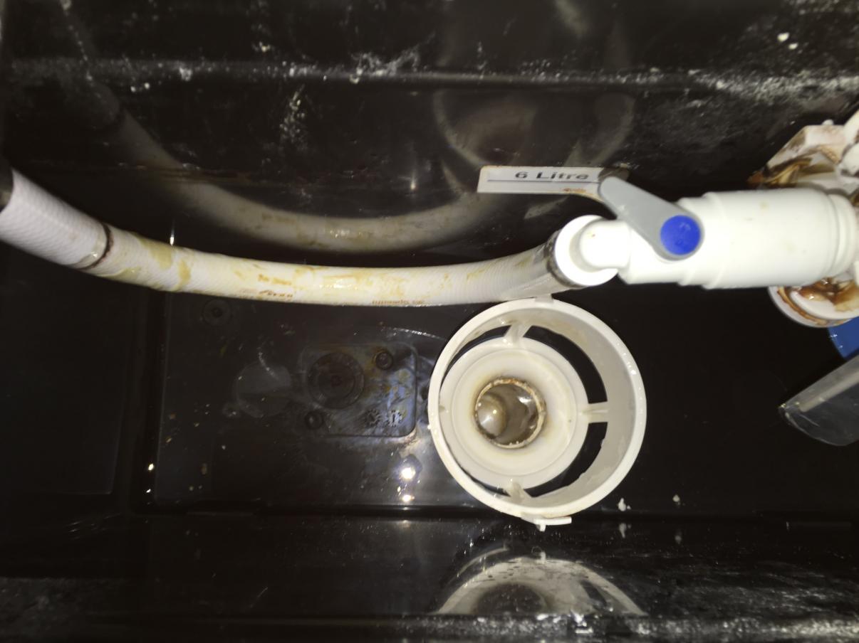

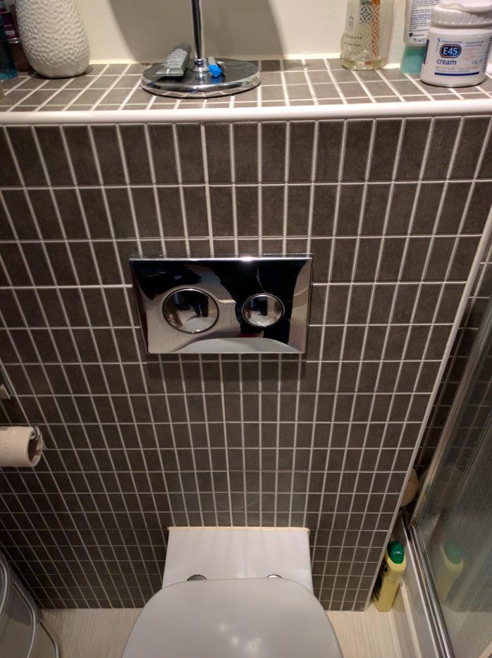

My ideal standard toilet (concealed unit) was leaking into the pan. Changing the washer didn't solve the problem. We discovered one of the clips on the unit which holds the flush valve is broken. Does anybody know how these holding units are replaced? Do they just screw out, for example? And how are they accessed? As the whole thing is behind a wall, with only a small hole behind the flush plate for access, it is very difficult knowing how to fix the bloomin' thing!
We are assuming the broken clip and the flush valve being loose is the cause of the problem.
