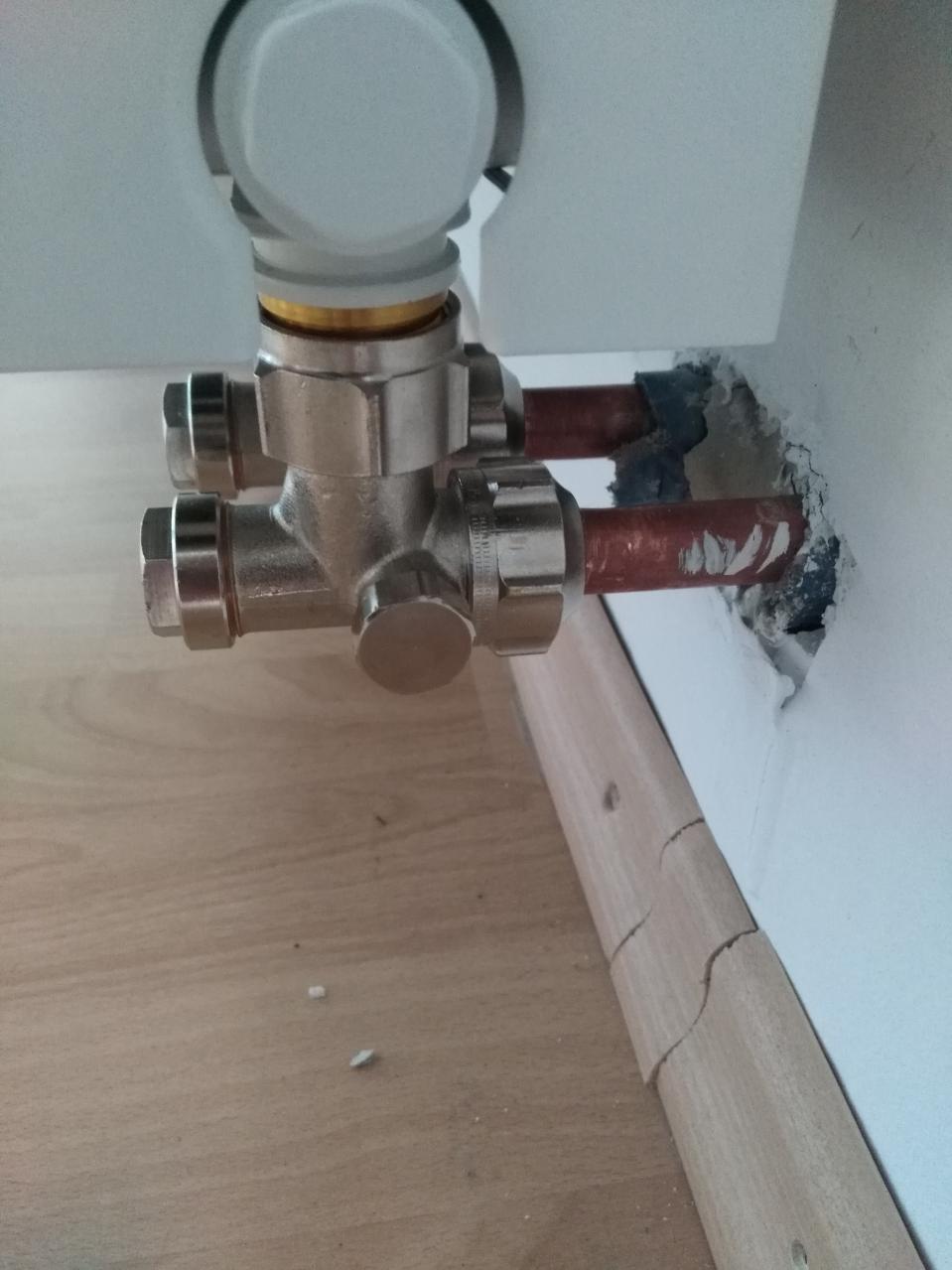

Presumably there were radiators there previously? Did he literally just replace them like for like, or did he modify the pipework?
Are you able to post some photos of the pipework connected to the rads? The more you can show the better - we need to see as much of the pipework as possible.

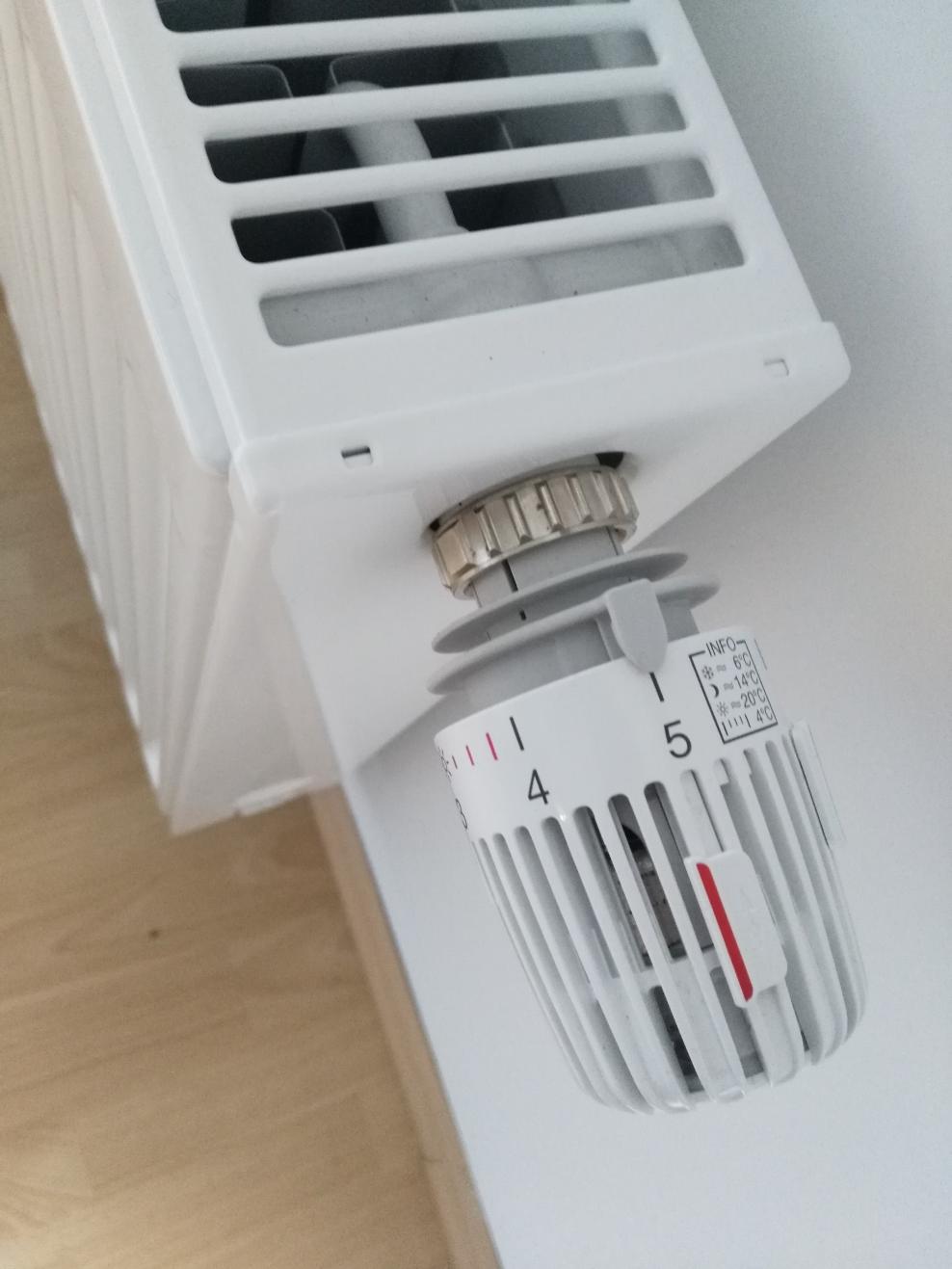

I have attached some images of how the pipework connects to the radiators. Our plumber said we have a mixture between a one- and a two-pipe system: It switches between one and the other, which is what I understand is causing the problem.
Quick update: I just tried turning off all of the radiators in the house, and turning the three non-functioning radiators up to full. The three then heated up -- the one in our bedroom was slightly cooler than the two babies' bedrooms. Some of the other radiators in the house were slightly warm despite being turned off completely -- specifically, the three nearest the boiler (cellar, downstairs toilet, near front door).
As far as I am aware, he just replaced the radiators like for like and did not modify the pipework. However, last time he was here and identified that there is a mixture of one- and two- pipe systems, he tried to put them both onto the same one: But I don't know which, as I was at work and my wife can't remember.
Previously, he had assumed it was a one-pipe system.
