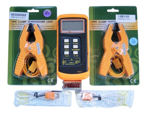

I ordered more of the little digital thermometers on ebay as they are less than £3.50 each. And for accurate radiator balancing for dummies I ordered one of these:
It can display either temperature reading from the clamps and / or the actual temperature drop. I would like to make sure all rads and precisely balanced so this should do it.
