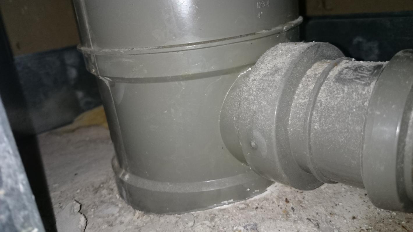

I have a customer who seems to have an issue with a blockage in his 40mm bath waste which drops down to 32mm pipe just before going into a 4" boss connector. In other words I believe an obstruction has passed down his 40mm pipe but is now lodged firmly in the 32mm section. Whilst hopefully I should be able to remove this by cutting into the pipe just before it reduces down, there is a reasonable chance I may have to cut into 32mm fittings themselves which means that, I may have to do something with the 4" boss connector. He may also want the boss connector replaced in order to prevent this kind of thing happening again. The problem is of course the boss connector is glued with the bottom of it also in concrete so changing it would be no easy task.
The question is therefore what do people think of possibly replacing the connectors boss with a new strap on boss?
