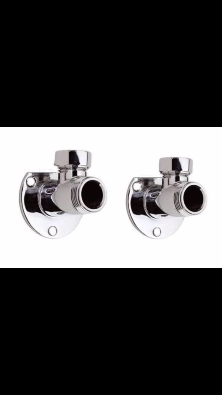

As the pump is in the airing cupboard and the pipes are surface mounted. I would adjust the pipes to fit into a set of external pipework elbows. Then fit the shower onto these elbows
They look like these
Yes, the pipes come down from the ceiling. Thanks, those connectors look very useful, but what would I use from the connectors to the shower as the connections on the shower itself would be much further apart? Could I use flexible pipes, or would this affect water flow?
