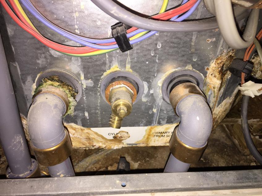

This is the 'main' photo, showing the difference between the lack of corrosion on some joints compared to the others.

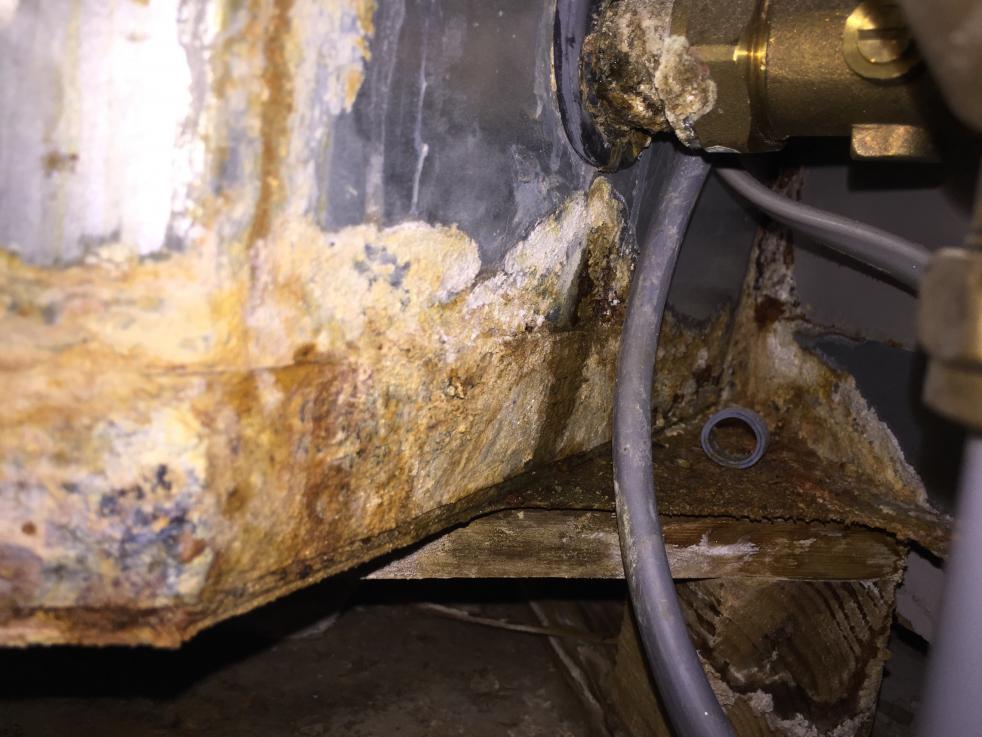

This one shows the seam and brown spot where the engineer believes the outer shell has actually rotted through.

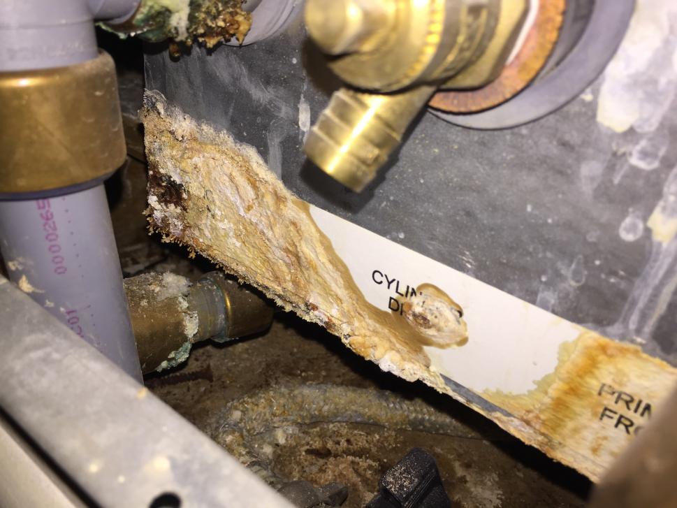

And finally, this one show the joint that 'weeps'.
From the photos, would you guys also say that the inner copper cylinder's split?
Based on the photos , I would be suggesting a replacement unit, and quickly looking at the condition of that - I would think Gledhill will be 2/3 grand having seen some of their quotes. Units very good when working but can be very problematic with spares expensive.
Unvented etc. likely to be expensive to install but generally cheaper in the long run.

i would be draining and cleaning up those joints looks like its the fitting rather than the tank might be worth 2 hours labour as there a chance thats all it needs
That's a good shout actually, obviously I'd much rather pay a few hundred quid to sort it than a few grand!
I assume this is something a competent plumber could do, as opposed to needing a heating engineer? The problem obviously seems to be people are afraid of touching these sodding Boilermates!
its a bit of a gamble but those plastic fittings are prone to weep ive got two under my stairs that grow calcite so obviously weep a little you need to find a plumber and offer him the job and explain you understand the risk its probably not the tank as that would be pouring out even from a little split or perforation where as the fittings do weep

I had two local guys come out, both essentially said it was goosed and to get it removed/replaced.
After chatting to a couple of engineers during my "Go on then, what would you recommend?" phase it looks like I'll be going with completely removing the thermal store and converting to a combi (Logic Vogue 40). It should provide the hot water needed and frees up the airing cupboard completely which is very useful in a new(ish) build house.
