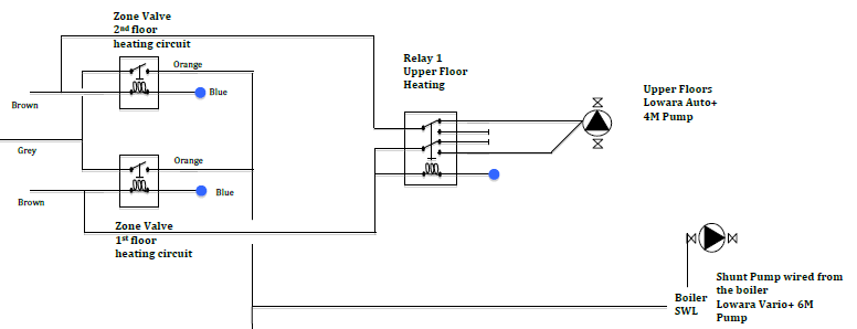

I'm revising a system for a customer, it's a large property that really does need zoning but he is not keen on the idea of having all the floors up. In short, I'm going to remove an old heat only boiler and standard S Plan and have a system boiler run a primary circuit and install a low Loss header. Ultimately I aim to improve the poor flow of the heating system.
There will be a 15/60 pumping into an UV cylinder from the header and use a Grundfos Magna1 to circulate the heating system. The wiring is my challenge, it's all standard S Plan, however I need the pumps to run independently as they have their own circuits from the LLH, if I wire them both in at 10 on the wiring centre at the switched live, I will find both pumps becoming live by way of a back feed.
I pondered wiring them from the stats but didn't like the idea of the Magna1 coming on at the same time the zone valve gets it's first live rather than off the orange. So I thought maybe a time delay relay of 10 seconds, but went off the idea when I tried to source one. So now I'm thinking of using two 240v SPST or SPDT, using only NO, relays one after each of the zone valves and before terminal 10. The relays would stop a common back feed and the pumps can pick up live from the orange of the zone valves, leaving 10 as my switched live.
Has anyone else come up with anything else? I have a diagram I can post if anyone is interested.

Thanks Chris, its an 8 bedroomed property with a total of 26 radiators. Its 20 years old and today would have needed to be done very different. I have knocked up this sketch, it has none of the usual S Plan stuff on, it just deals with the pump control, it should make sense.
As I said personally if only one pump to one zone valve I would take it from the live out of each stat before it goes to brown wire on 2 port & just leave the end (micro) switches to signal the boiler. That way relays are not required.
The room & cylinder stats have reasonable switches but you would need to check the carrying capacity of the micro switches & the start up draw of the Magna1 25/80 pump if you were going to do it your way.

Like you say Chris always worry about the rating of the valve micro switches, like the man has drawn external relays are always nice, he wont go wrong doing it his way
Trouble is Chris, and I get your point because that was my first plan, is that if I don't use the relays then there will be some noise as the Magna1 effectively pushes against a closed valve, it's a big pump. I am not sure that the pumps smartness will help? I need to signal the pumps to start only once the zone valves have fully opened, hence energising the relays using orange. All the relays are doing is acting as electrical non return valves in allowing the pumps to start on the normal green light the oranges provide.
It's a logic plus system boiler so it won't need a shunt as such, it will pump the primary itself with it's inbuilt pump. I don't use regular boilers any more it's just added expense and hassle sealing them.
It's a fair point, the Magna1 max draw is 1.03 amps so the micro switches will handle it, it's more about having the two pumps running at the appropriate time for the zone valves and being able to run one or both pumps at the same time. If the relays come out then nothing will stop pump 1 energising pump 2 each time a zone valve is called for.

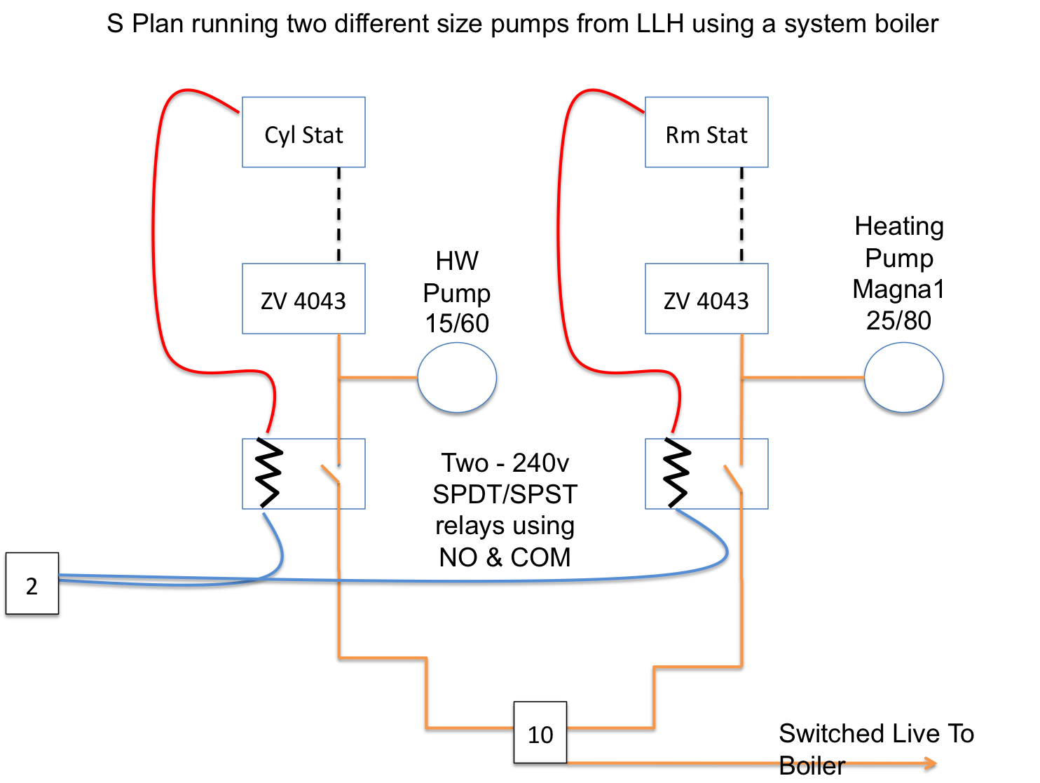

relay LLH.PNGI only used one here cos had 2 zone from 1 pump but if only 1 & 1 remove relay.
If you only have a load of 26kWs those pumps are might big to shift the water required, remember you have taken out the biggest resistance i.e. boiler, by going for the LLH a standard alpha 15/50 set low will murder a domestic cylinder on 22's
Chris I really appreciate what you and Ermi are saying, it's a quality thread and good discussion. I'm stuck with using two ports because of the cylinder no matter which 3 port we use. Building control are involved in the project so the unvented side needs to be text book. And your diagram is sound, similar to mine in principle. Your comment about the pumps is also good, and I had considered that. The fact is that I'm trying to resolve a circulation problem that ideally should be done using pipework, but the customer doesn't want it so I've come up with an alternative. I also want to fix it in one hit, so after some discussion with Grundfos over resistance decided on the Magna1, I guess I want to be sure I don't have to go back and upgrade pumps later? The system is over 25m long and all rads are on 8mm. I can't even find out if it's manifold or simply reduced.

In case anyone has an interest I completed and commissioned this system on Friday as planned and it is running beautifully, the pumps are doing a text book job and the DHW and Heating circuits are performing perfectly.
The relays I used were 15amp SPTT using the normally closed to control the orange switched lives from the zone valves to 10, with the relay coils being driven from the lives from the two stats and there is no pump conflict. The Magna1 was expensive but the trade off for the customer was worth every penny and he says he's never had heating like it.
I used a Worcester Bosch LLH as I liked the insulation pack it comes with and everything is very very quiet.
