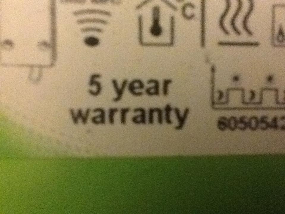

DELTA DORE’s warranty runs for a period of 24 months.
just read this it says 2 years???
