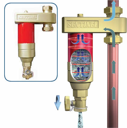

Has anyone installed or used the Sentinel System Filter? How does it compare to the SpiroTrap MB3?
Due to its smaller size it may be ideal for where we want to have it installed.

The MB3 is really just an a MB2 with an added magnet on the outside. Personally I wouldnt trust them. I prefer either a TF1 or a Magnaclean, that way you can see what you are catching, instead of just flushing it out with system pressure.
My preference would be the TF1 over the MagnaClean however, there isn't enough space to fit either under the boiler.
The local sentinel rep was in the merchants the other week and I had a bit of a look at one, seemed well made must be fitted on a vertical section of pipe. Cost is same as others give or tak a few quid. I wouldn't go out my way to try one though have been happy with magnacleans.
Tried 1 when they first came out a couple of years back. Didn't like it much and never fitted another.
