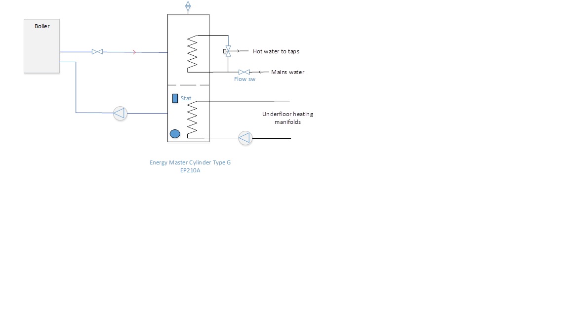

System from boiler perspective is very simple .. Baxi Barcelona connected to a Thermal Store (EnergyMaster) - whole contents of store pump circulated around boiler ... no rads.

There are 2 heat exchangers .. upper for DHW lower for UFH ... and there is a baffle across store to control stratification.
I do plan to add a mixer valve on UFH ... but it is not in the design installed (package desiged & supplied by NuHeat)

Here is a basic sketch if that helps ... (bypass & pressure vessels omitted for clarity)
