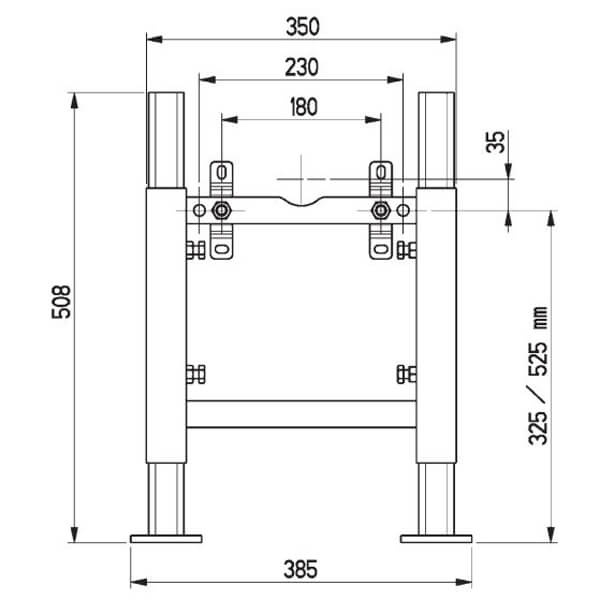

I have found the below wall hung frame which has the following dimensions, 385w x 140d x 325-525h. I would place this cistern on the frame.
If I take the shortest height adjustment of 325mm for the frame and add it to the total height of the concealed cistern including the flush pipe @ 430mm I would get a total combined height of 755mm?
Are those calculations correct?
I also want to know where I can find a suitable low cistern compatible wall hung toilet to allow for the small height not giving enough force for the water to flush the toilet properly.

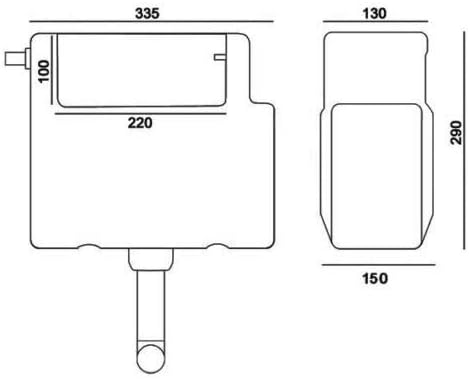

If I buy this frame along with this cistern I will get a floor to top height of 770mm. The frame height is 360 to the centre of the flush pipe. If I include the cistern with a height of 290 plus the 120mm flush pipe height to give me 770. Are my figures correct, or should I be allowing for a higher flush pipe?

Your choice mate I like to keep it higher so the toilet pan can be fitted at comfort height which is 480 mm to the top with the seat on 500mm, just be aware of that also. Kop
800 furniture frames are the lowest you can get. Even with a separate cistern you will still find that you can’t go lower.
if you do, you will only be lowering the toilet pan, which won’t work.
the only other solution if you can’t increase height is to locate the cistern elsewhere and pipe the flush pipe to the wc.

I actually found Geberit Duofix 79cm Furniture Frame for a Wall Hung WC which is 790 tall. Geberit told me themselves it can be lowered 50mm to 740mm. I do not quite believe them so I have ordered one from ebay to see how low it can really go. If I get stuck I can place it directly on the wooden floor 10mm below the bathroom floor tiles to make it only 780 tall. I could probably shave another 10mm off by cutting into the floor and having it 20mm below the bathroom floor tiles. I also have the option of cutting a cistern sized recess 10mm into the 20mm shelf.
