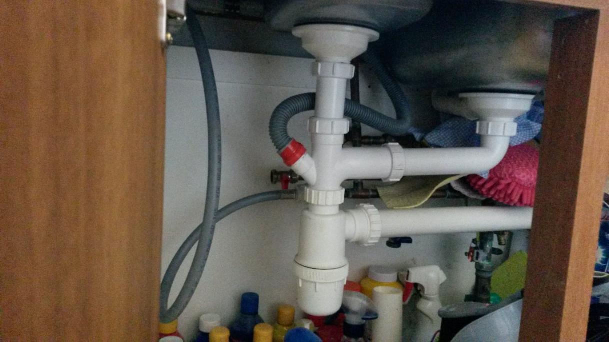

Post a photo of under the sink and the connections, seen pipes running uphill before now Steve, and without wishing to offend the word believe doesn`t help us to help you, facts do mate.
I'm in with Hammers, hepVo's work wonders for this. That's unless the waste drains straight into a spigot on the trap. A photo would help no end.

Here's a photo of under the sink... hope this helps!

that looks ok it may just be the way the machine cycles the pump cutting into remove water during the drying cycle
youll learn to hate that bottle trap after the 5th time youve cleaned it out and the seal leaks every time
