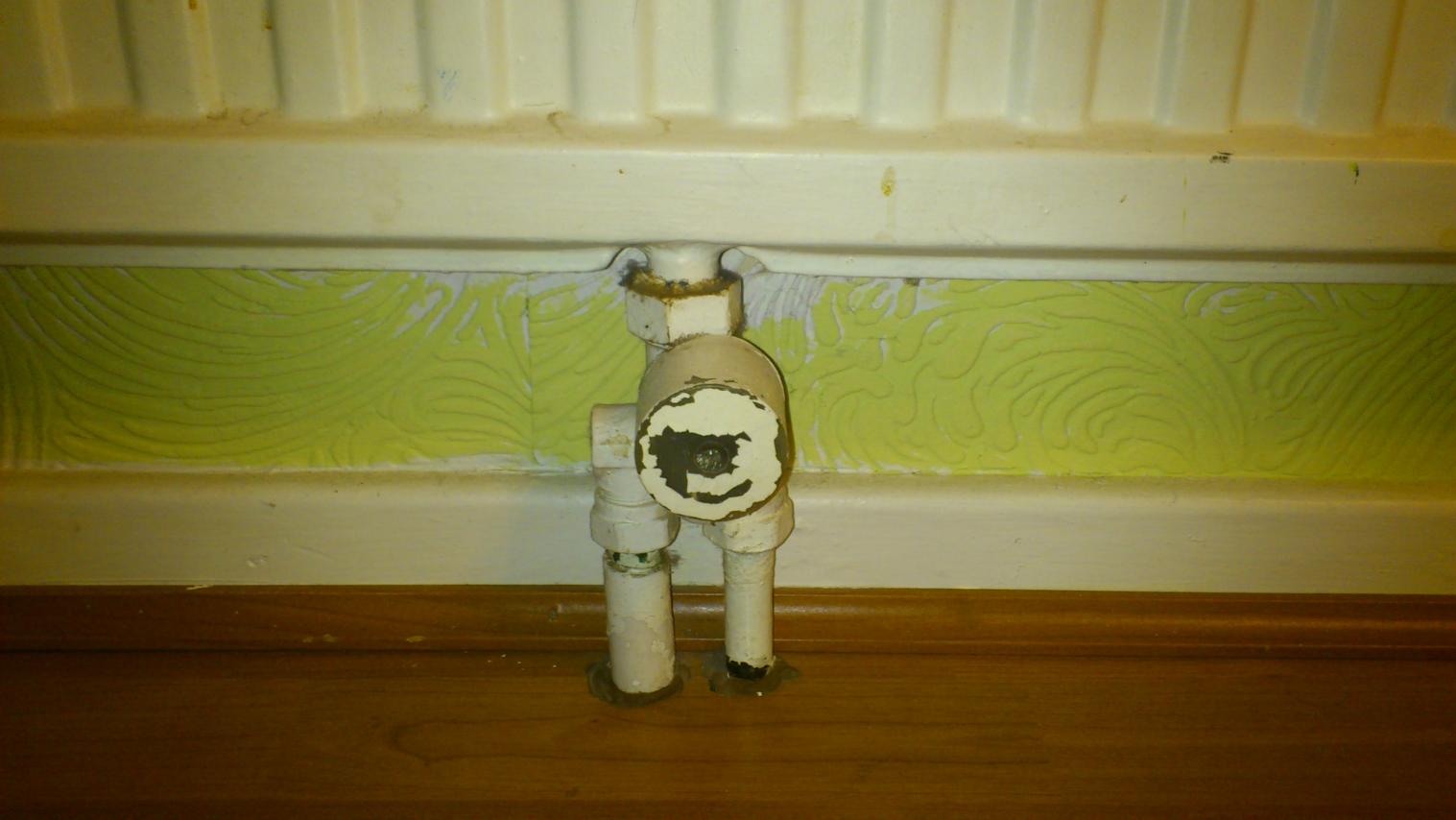

I have potterton Combi 80 boiler with sealed/closed system that is running on the single pipe (i.e. no separate feed and return pipes). Additionally, the radiators have single outlet on the bottom middle rather than separate inlet and outlet on each bottom side.

I'd be interested in seeing those rads Pw123! Thats a new one on me ....
A combi 80, single pipe system, weird sounding radiators ... My best advice would be replace the lot!
However if that isn't an option then with what you're describing I'd say X400 in for a week or so as you describe ... Then drain it all off ... Remove each rad individually and flush through with a hose ... They must have a flow and return! ... Then refill and drain a cupl of times before adding the inhibitor on the final fill!
Even better still; get some quotes from other plumbers to verify BG's findings before you start 🙂
Flushing it wouldn't really help clear the rads on a 1 pipe system (if it is a 1 piper) flushing them just tends to clear the pipe work. I've never come across those rads/valves before, might be some sort of twin entry set up? Has it always been a sealed sytem? If not previous air ingress could have caused a sludge build up before it was sealed. I agree with diamondgas, get a second opinion.
Interesting that BG would advise powerflushing a one pipe system which is a complete nightmare to do and in fairness rarely ends in success. I would advise putting a bottle or can of F5 in and leaving it for 3-4 days of the boiler firing. Then dump at the lowest points, you could try main fill flushing by leaving the draincock open and the filling loop open.
Thanks diamondgas and GasManMike - I have attached a picture of the radiator for you to take a look and give me your expert opinion.

Only way to clear sludge from the rads on a one pipe is to remove them and hose through.
One pipes have not been fitted domestically for about 30 years so you system predates your boiler.
Can't see your rad photo.
pw123 ... no pictures .. however a question B4 you replace the boiler ... when you turn the hot tap off does the flame estinguish imediatly (no call for heating) or stay on for a short period of time.
Sorry guys forgot to attach the photo.. here it is now..

DSC_0002.jpgPicture of the radiator

Those rads are ancient my friend crikey I'd forgot they existed and i've been here some 34yrs...
